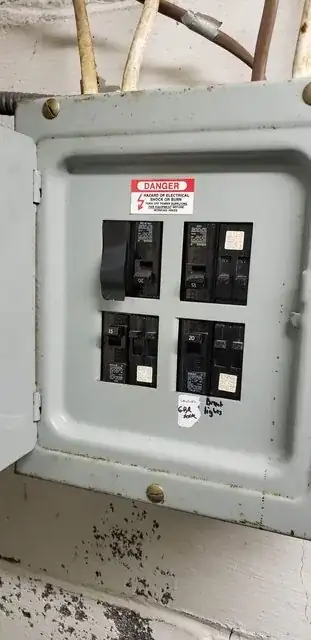

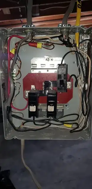

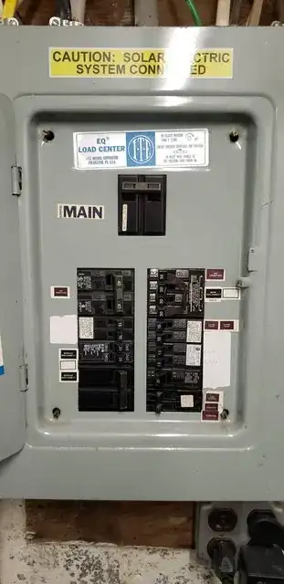

Photos (click to enlarge):
Current Sub Panel
Main Panel
Small Extension Panel beside Main panel
The plot thickens lol (im ditching the oven circuit for now for ease of understanding but will likely look at full upgrade anyway)
So turns out in the sub panel off the main panel there is a cable for the dishwasher and washing machine already! So i figured as the washing machine one goes over the same area of the basement i want to move the laundry room too i could pull it down and use it but now it gets odd. It seems like (from my research) this is wired as a split phase shared neutral (as per here: Term to describe two circuits run through one /3 cable) and in the receptacle i can see an entry and exit wire so i assume the exit wire goes off to the dishwasher. The wiring in the panel is odd. There seems to be 2 double pole breakers, one is 15A/15A the other is 15A/20A! The wires are split between them. Is there any easy way these can be split back to single dedicated lines? (excuse my horrific diagram)

    You will almost certainly want both a larger feed (wire **and** breaker) to the subpanel, because even one of those items (electric dryer, oven) would max out the 30A feed. But such a small feed also typically means (but not guaranteed) a very small subpanel. **Upload pictures of the main panel and subpanel** and the experts will tell you what to do - which may range anywhere from "new cable between the panels and start adding breakers" to "rip & replace". – manassehkatz-Moving 2 Codidact Dec 04 '20 at 15:54

  • Thanks for the feedback. Added photos to main post – RossMcC Dec 04 '20 at 16:15
    Really the only thing I would think about is upgrading your service panel. It's already over subscribed, you have multiple non-listed breakers, and at best poor circuit labeling. – NoSparksPlease Dec 04 '20 at 16:31
  • @NoSparksPlease Yeah! big time. The labeling is awful: 4 for "service or main disconnect"? What's that about? And 2 for A/C? I also don't get the 3rd pic. The OP only mentioned 2 panels, what's up with the 3rd pic? But yeah, I agree, time for a major upgrade to prep for the future. – George Anderson Dec 04 '20 at 16:44
    Have you considered a service upgrade? You're thinking of adding up to 80A of load (30A dryer and maybe 50A range; I'm assuming both are gas presently), but you only have 100A service. It would be worth your time to do a load calculation for your whole house to make sure you've got enough power for what you're planning, and then ask your utility if it's possible to upgrade. Some utilities will even do the upgrade for free, since it means you will be buying more power from them, and 200A is a more standard size today anyway. – Nate S. Dec 04 '20 at 18:08

  • How many square feet is this house? Also, can you post photos of the *labeling* on the inside doors of the panels involved please? – ThreePhaseEel Dec 05 '20 at 00:34
  • About 2000 square feet. By labeling do you mean what each breaker does? If so its pretty non existent. TBF the majority of the electrics work fine, some are just wired a little oddly from my amateur view – RossMcC Dec 05 '20 at 03:52
  • @RossMcC -- I mean the manufacturer's label on the inside of the door -- that has useful information for us here even if there is no directory of which breaker controls what. Also, those are "double-stuff"/"tandem" breakers you're looking at in the "side" subpanel, *not* double-pole breakers! – ThreePhaseEel Dec 05 '20 at 04:40
    **Those are not "double-pole" breakers.** Those are **tandem breakers** aka twin, duplex, cheater, double-stuff etc. There's a horribly wrong way you can use a **multi-wire branch circuit** with a tandem, this isn't it - they made *some* effort to avoid that firestarting mistake - but it's still a dangerous mess. The two involved tandems need to be replaced with a quadplex. – Harper - Reinstate Monica Dec 05 '20 at 19:55
