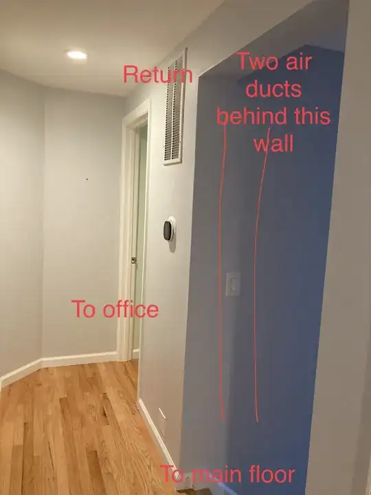

We bought a new house a few months ago. I do not recall hearing this noise in the summer, when the AC was running, but then I wasn't in this room that much so I am not sure if it was happening.
We have a 3 floor house. HVAC system is in the basement. In the top floor, there are two air ducts right next to each other, both columned by dry-wall. One goes up to the attic and I assume feeds the air to the other rooms. The other is the return. The other end for both is in the basement.
The space for the duct is next to my office room.
When the heater is running, every now and then I hear a tapping noise coming from the duct. If the heater is off then no noise. Again, not sure if the noise would be there with the AC on.
It sounds like if a wire was tapping against something but there are no wires inside the ducts -- not that I know of.
I cut a 4" square into the drywall in front of the return duct and the sound is definitely coming from near/in/around the return duct.
There is no insulation around the return duct -- so its just hollow space.
I don't mind doing some work to identify the root cause but I have no clue where to look/start.
One person claimed it has to do with the lack of insulation because the air duct gets hot and is tapping against the wood beams. Could it be that? Any cheap fix?
I am including some pictures too.
from top floor,pointing to where air ducts are

I don’t insulate interior ductwork either. But I think what you are hearing is the expansion and contraction of the metal ductwork. The noise can go on for quite a while when heating and then again when cooling down.
Stopping this on a verticals run is really tough and no cheap fixes I have heard of consistently work. I have had people tell me they drilled a series of holes and shot spray foam and it helped, this same “fix” had caused the duct work to start buckling or oil can popping every time the fan turns on or off and this can get really loud. When that trunk line is more than 1 floor I will use a double layer of neoprene rubber 1/16” at the straps. This keeps the duct from moving on the framework the rubber spaces the duct and absorbs most of the noise but not all there can still be creaking at the joints I have tried to use silicone when assembling and jell type sealer that was available in the 80’s nothing has worked as well as the double rubber. The problem with double rubber is it takes space and is kind of expensive last would be almost impossible to do after install.
If you try spray foam make sure to not fill the entire cavity because when it expands this causes the oil can affect if you don’t like the tapping you will hate the oil can.
  • Spray foam behind the drywall? – IMTheNachoMan Dec 04 '20 at 22:10
    Yes, several people have told me it worked but one person I think he used two much. They called me to fix it after looking at I told them the best thing would be to remove the Sheetrock and see if that could eliminate the oil can effect but to eliminate the ticking was usually a major job and I could not guarantee totally eliminate the noise, he pulled the Sheetrock removed the foam then wedged some type of tarp between the metal and the wood. The friend that recommended me said the tarp worked fairly well and it was livable after they put the Sheetrock back on. For others the foam has worked. – Ed Beal Dec 05 '20 at 01:07
