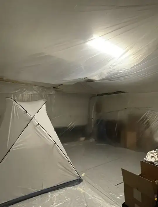

Here’s my setup. First time using a paint sprayer and will be using oil based primer Zinsser Cover Stain, which smells badly:
Is this overkill for cabinet refinishing with a sprayer?
So far I’ve been using a small fan and opening the garage half way and opening then sides for ventilation in the daytime. During the day, it’s about 70F and at night time it gets down to 50s (I keep the small fan on). I life in LA so humidity is low.
What should I do differently to help speed up the dry time for my primer/paints?

This is a matter of opinion; in my opinion yes that is overkill. Plus, you have created a humidity-trapping box. Think about professional spray booths; they are equipped with powerful ventilation systems.
The product guide says to apply "only when air, material, and surface temperatures are between 40-80°F and the relative humidity should not be greater than 85%". Right now in my part of LA it is 40°F and 76% relative humidity. It is likely that as air temp rises, the material you are painting will take longer to warm up.
I think you can improve dry time by increasing air circulation and temperature.
