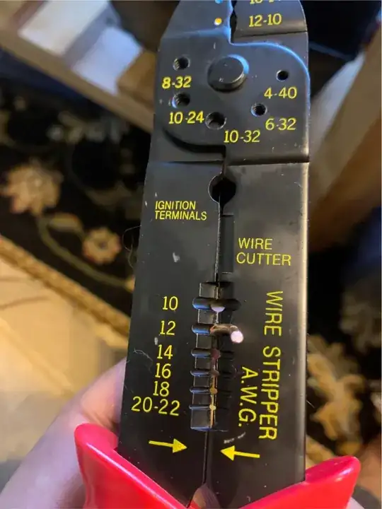

The wire is going underground for about 50 feet. I bought a wire cutter with the little holes to measure the gauge of the wire. The stripped copper goes into the 12 gauge hole almost perfectly.
Can I safely assume that the main wire going into the shed is 12 gauge then? Am I measuring the gauge of the wire properly? If this is the case, for a 50 feet run, how much amperage does a 12 gauge wire bring to the shed?

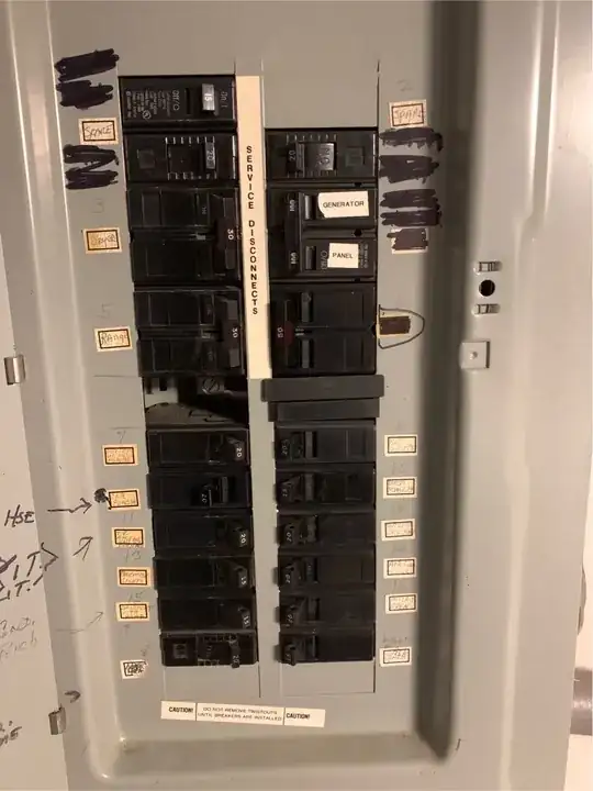

Breaker box from the house: the switch numbered 20 is the one going to the shed. I imagine you would’ve liked the pic without the top cover in the box but I’m not sure of what I’m doing, so I am kinda hesitant and scared to take the cover off

  • There are several 20A breakers in your photo of your panel, which one are you referring to? – ThreePhaseEel Dec 06 '20 at 19:47
  • @ThreePhaseEel oh! Haha this shows how little I know about electrical. The one that’s turned off. I thought the 20 was the number for the switch, not the amp rating of the switch! Didn’t realize that there are other 20’s to figure out that it was not the switch number. – Crazy Cucumber Dec 06 '20 at 20:00

That's a way to measure the wire size, but the wire size should be imprinted on the jacket of the cable (or printed on individual wires that are not in cable, which does not appear to be what you are describing. If your conduit extends all the way, or you dig up the cable to put in one that does, that's what you might replace the cable with.) So you should be able to determine wire size just by reading the outer sheath.

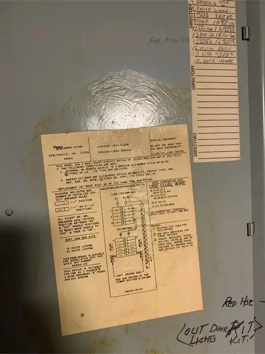

A little more based on the panel pictures:
You have a Rule of Six panel. That is supposed to mean "maximum of 6 breaker flips to turn everything off". However, you have 3 double-breakers (great) and 4 single breakers (not good). That is a total of 7. 7 > 6 = code violation. From a practical standpoint, that is kind of OK, because the top section (labeled SERVICE DISCONNECTS) has everything and in an emergency it would be "flip everything off in the top section". But technically wrong.
The design of the panel (that's where the diagram is critical) is that the middle pair of slots (one uncovered, one with a strange cover) are not used. Everything else in the bottom section is full. So if you do want to add a subpanel, the way to do it would be to move one of the single breakers from the top to the bottom, replacing the existing 20A feed to the shed. Then put in a double-breaker to feed to the shed. However, that would still leave you with 7 flips in a rule of 6. Two ways to fix that:
  • Move the 15A to the bottom. Replace the 2 20A in the top with a double-20A.
  • Replace one of the 20A breakers in the bottom with a double-stuff/tandem breaker, letting you move another one of the upper breakers to the bottom.
