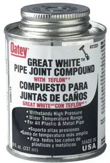

Pipe dope
Pipe dope; also known as pipe joint compound, is used to seal and lubricate the threads of a threaded pipe joint. It's available for both water and gas lines. It's applied by simply brushing it on the male threads of the pipe joint, before the joint is fit together. Pipe dope never hardens, and will not crumble and fall out of the joint.
