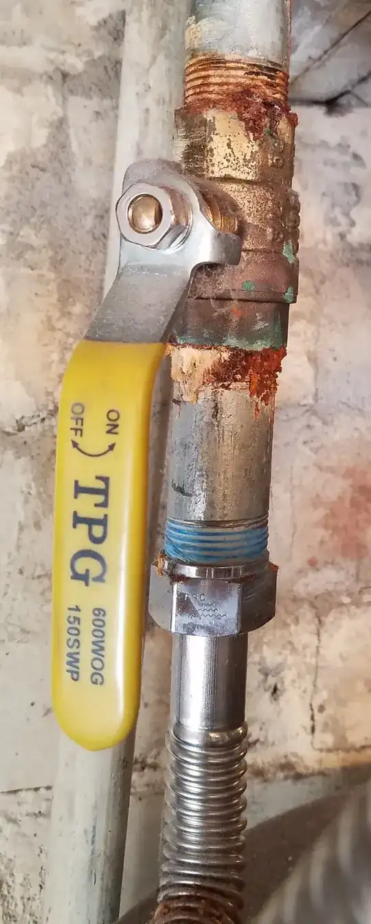

This water heater was replaced by a plumber 4-5 years ago. Within about a year, all the new connections were rusting/corroding.
Did the plumber not sufficiently tighten the fittings?
Is this perhaps an electrolysis problem?

  • If nothing else, check that the 1/4 turn stop valve is still effective, The outer corrosion may mirror what's going on in there too. – Tim Dec 09 '20 at 18:51
  • Your valve looks like mine did, just before it broke off in my hand when I went to turn it off. If you haven't already, I'd suggest turning of the water elsewhere, relieving the pressure, and cranking hard on this valve a few times to check to see if it's compromised. – LShaver Feb 15 '21 at 17:20

Looks like minor leaks, compounded by mixing galvanized pipe and copper/bronze valve without using dielectric couplings between dissimilar metals.
Honestly, any plumber installing NEW galvanized pipes (rather than just making repairs to existing) in the past 5 years is doubtful. If you really want threaded pipe, stainless is available and lead-free, which galvanized iron pipe is not.
    Brass is compatible with both copper and galvanized steel so as long as copper wasn't attached to steel then there shouldn't be a need for dielectric couplings. – MonkeyZeus Dec 09 '20 at 13:40
100% galvanic corrosion, "Pipes in the house are a mix of copper, galvanized, and pex", different metals cause corrosion. You should stick to one type of metal in your pipes or use pex.

Yes, you have small leaks causing rust. See how the rust practically flows like water in this picture?
Overall, galvanized pipe should be avoided nowadays as there are much better options such as pex. Ever seen the inside of an in-use galvanized pipe? It looks exactly like what your seeing on the outside.
I would not try tightening it further as you will introduce new problems. You can leave it be if the leaks aren't pooling anywhere or get things re-piped with plumbing that doesn't have this issue.
You can try galvanized steel again but just make sure all the connections are properly sealed with tape or dope and are screwed on tight enough.

The galvanized pipe is what is corroding and rusting. As noted,there may be other factors at play here like leaky connections but the galvanized pipe is definitely a problem.
You should re-plumb with cooper pipe, or pex, and make sure to use a Dielectric Nipple on the inlet and outlet of the water heater.

The zinc was cut off when the pipe was threaded and most rust is from bare steel threads . There may be a bare steel close nipple in there also. So the zinc/galvanized is pretty much doing it's job where it was not removed. The moisture is from condensation not leakage. If you replace it with new galvanized ( which contains no more than a trace of lead) the labor will be costly. Same high cost for stainless and copper. Or ,you could wire brush off the rust and put on some grease for very low cost ; and hope there will not be much more corrosion. I doubt there is significant metal loss . mostly it looks bad.
