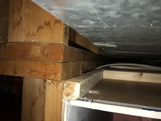

The wall in this picture is in the middle of a large, previously framed but unfinished basement.
I'm trying to figure out if there is proper support in the top beam for me to remove a stud (or two) to create a doorway. All wood is 2X6.
Can anyone help?
same
same

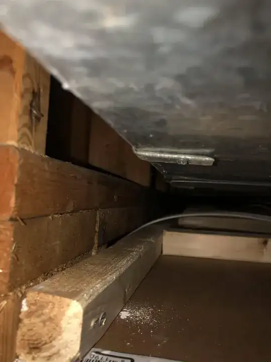

top of the back of same wall enter image description here

    You're the first _I've_ ever noticed that's gone from posting a "follow up" question to actually asking your own - congrats! Can you get us a closeup pic showing that wall header and what it's attached to above? It doesn't look like it's particularly well attached, which leads one to believe it's _not_ load bearing, and that means you can pretty much hack it up however you want, however, a better look is required, first... – FreeMan Dec 15 '20 at 16:21
  • That looks like a load-bearing wall. Without an engineer, you can use lumber industry tables to determine a conservative header size, if you understand the span of floor supported by that wall, as well as any snow load required for your region. Here is a good resource: https://www.southernpine.com/span-tables/headers-beams-size-selection-tables/ tables 7 - 12 – Jeff Wheeler Dec 15 '20 at 17:07
Are these wall studs for your first floor?
If so then you need a proper header above the door and double up or triple the 2x6 studs on the outside of the door to support the header. The header should have 3 boards to accommodate the wall thickness. A 2x6 header is probably sufficient but I would go for 2x8 or 2x10 if it doesn't impede head clearance. Better to over-engineer than to under-engineer. Speaking of engineer, you may wish to consult with one.
It's looking more and more like a load-bearing wall. I don't think they double up the top plate for the fun of it when building a cosmetic wall.

  • Thanks for your answer - the red circles you've indicated are the bottoms of 2x6s - maybe about 6 inches high, that then support another single horizontal 2X6, that in turn supports the joists for the floor above. Those joints run opposite the joists in the basement as seen in the picture. I'll attach additional pictures above of the back of the wall shown if that helps – Tim Dec 26 '20 at 18:01
  • @Tim I would treat it as load-bearing and support the new doorway opening with a header like I illustrated in this other answer: https://diy.stackexchange.com/a/177708/42053 – MonkeyZeus Dec 28 '20 at 13:15

    Thanks for your help! I've taken two additional pics of the back side of the wall pictures behind the two top beams, but can't figure out how to add them to the post. The wall DOES run parallel to the ceiling joists above, but the joists for the floor above run in the opposite direction. I don't see any stem walls or anchor bolts anywhere along the wall. If it makes a difference, there is a metal beam in the basement ceiling running in the same direction as this wall, and the interior end of that beam ends about where this wall starts, just about 10 feet away from the begin of this wall – Tim Dec 26 '20 at 18:08
  • I’m confused: does the steel beam support the floor load above and not these joists? – Lee Sam Dec 26 '20 at 18:42
A closeup pic would help. It looks like blocking installed between the joists and the wall below is non load bearing. But, you'd have to confirm this by looking at what's above the joists on the next floor above. If there's a wall or posts on the same spot, then it's carrying some load and will need to be header'ed out with double and jack studs/etc on either side of the new opening.
You can triangulate the location and transfer to the floor above to find if there's weight on this wall or not.
more pics of the metal beam you describe would help.
A bit confused by the early pics. Is that above that basement wall? Then the blocking between joists is making a chaise for the hvac ducting. Is that so?
