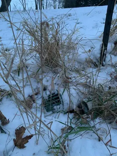

My sump discharge is run under the basement foundation, then underground for about 300-400 feet, then pops out of a small mound on the side of a slope. When investigating the outlet this morning, I found it completely covered with snow, and no signs of water leaving the pipe.

  2. There are two pipes leaving the mound, the smaller of the two is the sump outlet, the larger is what I believe to be connected to the sump vent (Air vent out of the top of the sump pit) (But I have not verified this).

  • Unfortunately, I am not the one who had this house built (Bought it from some people that built it and never lived here), so I don't know who the builder is or how to contact them. Running a hose in the end is a great idea, and I'll be giving that a try right now (I think I've got just enough hose to reach it). – cyclops Dec 18 '20 at 14:58
    Aside from making a large muddy mess, shoving a hose up the pipe and letting it run did the trick. After getting the hose lugged out there in freezing temps, it only took a few minutes before the ice had melted enough to break loose and out. Once spring rolls around, I'll likely get to digging to fix this correctly. Thanks! – cyclops Dec 18 '20 at 17:59
