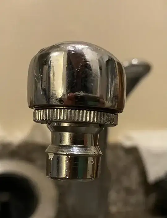

I have an SPT brand countertop dishwasher. I forgot to push the red drain button before disconnecting the hose from the faucet adapter. The water pressure blew off this black rubber gasket. I can’t seem to figure out where it needs to go in order to make a nice tight seal again that won’t soak my kitchen when I turn on the water!

top picture ... the bottom end of the silver piece ... that is were it needs to be when the diverter is pushed onto the metal piece – jsotola Dec 19 '20 at 07:50
In the groove of the silver piece just below the serrated edge – d.george Dec 19 '20 at 12:28
12nd photo: push it into the groove just above the ball bearings. – ojait Dec 19 '20 at 16:26
If it goes in the silver piece’s groove, then there is a trick to it because it isn’t creating a seal. Likewise if i am not sure what “groove above the ball bearings” to look for or anything. I’ve tried a few places but none seem to be doing the trick so far. Thanks for your suggestions – Alan H. Dec 19 '20 at 17:05
1I think @ojait has it.The ball bearings 'lock' into the beveled groove on the silver piece. This will create a pressure and the round tip of the silver piece should press into the gasket. – Steve Wellens Dec 19 '20 at 17:51
Yeah. I would have said that was below, which was throwing me off. I submitted an answer. Thanks, all – Alan H. Dec 19 '20 at 18:08

I figured it out. I’m not sure if this is the groove @ojait was referring to or not, but I was able to maneuver the rubber gasket into the spot inside the female side of the adapter below the ball bearings. I used a chopstick. The seal now is slightly leaky, exactly like it was until I messed things up yesterday. Thanks to all for taking a look!

1try wrapping faucet flange with Teflon tape a couple of times it may help stop leak. – ojait Dec 19 '20 at 20:10
FWIW, I have added a few layers of Teflon tape to the faucet flange as suggested and it did reduce leaking. That said, I am sure it would be even more effective on a threaded connector. – Alan H. Jan 06 '21 at 19:44
