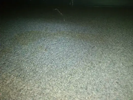

I own a home heated with the wall mounted wall heaters that need to be cleaned every year. The way it's recommended to clean them is just simply remove the cover and vacuum out to the insides, if not blow out with compressed air. This is already been done last year at the beginning of the heat season, and it's time again. The initial startup of them always has their accustomed smell of burning off whatever remains on the elements after cleaning, which can still leave a bit of a stink initially. Some of them still have a smell even though they have been cleanedenter image description here
This is a picture of perhaps the worst one, since it's got what looks to be soot coming out of the heater portion of it. This is one, as was all of them were cleaned just prior to this showing up, with compressed air and a vacuum to keep the dust from flying everywhere which work pretty good, all contained within a cardboard box cut out.
My question is, is there a way to clean these after I remove the heater unit from the wall sleeve which is very easy to do, and disconnect from the power, better than simply blowing air through them at the most? Is there a solution of water and something that I can literally wash them in to get them virtually clean as possible? Of course I would allow them to dry before reinstalling and turning the power back on them, but it seems these things provide a little bit more smell than what's necessary, and since this has been the case for the past 2 years since we have owned the house and not knowing what situation the prior owner had, I would like to clean them in a way they will no longer give out any odor at least for a season. Replacement for all of them in the house would be a costly proposition, so I really don't want to just simply buy new ones at about a $120 to $200 a piece, for the 9 or 10 I have in the house.
