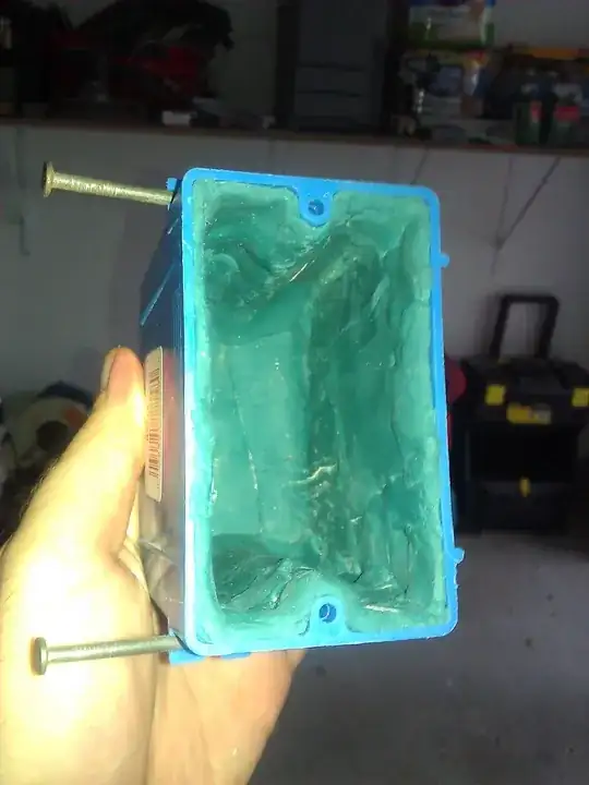

This leads me to me idea of putting the putty on the inside. I uploaded pics of a mock application. The outlet fits well and I think there would be plenty of room for the wires. I know next to nothing about electrical, though, and I worry about not accounting for things that might not play well with the putty.
Does anyone advise against this? I hope not because it's really the only way I can do this.

    Can't quote code but generally no because you need ample space within the box for the wiring, and the putty significantly reduces the available volume of the box. Also - dude - what the heck are you building?!?!? – The Evil Greebo Dec 03 '12 at 21:19
  • If I compress it enough all throughout, I can get it to 1/8" thickness. Does losing that much area really have that much of an impact on required space? As to what I am building, many have referred to it as a "murder room". – oscilatingcretin Dec 03 '12 at 21:23

    A flash point of 227C is very low and would be a potential hazard if a device in that box started arcing. Something like "Plasduct" electrical putty would be a better choice. Electrical putty is used in boxes and service enclosures to seal the openings around wires and is fireproof. – shirlock homes Dec 04 '12 at 11:20
    The first problem could be not enough open space in the box for the wires and device. In this situation you'll count each conductor entering the box as 1 (1 hot + 1 neutral = 2), all grounding conductors in the box count as 1 (3). The device counts as 2, so your box fill is 5. If you're using #14 wire you'll multiply by 2 (for #12 multiply by 2.25), which will tell you how many cubic inches of space you need inside the box (10 Cu.in. in this case). The other problem you'll have, is proximity to combustible materials. – Tester101 Dec 04 '12 at 12:22
