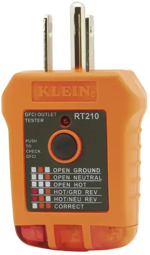

Welcome to the Magic 8-ball: receptacle tester
Harper calls these the Magic 8-Ball because they sometimes produce meaningless, seemingly random, results. But for straightforward wire swaps they are exactly the tool to use.
These testers make what you found out the hard way a bit easier - i.e., you can plug them into each 120V receptacle to very quickly find out what is going on. What you have would be described by one of these testers as Hot/Ground reverse.

You will likely find at least one receptacle wired incorrectly. Fix it and then test with a multimeter, though in this case using a Magic 8-Ball tester will speed up the process as this is right on target for that type of tester.
