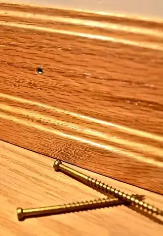

You could get something called a trim screw. They also sell them in white if you wish to match the color and not cover the hole with putty.
GRK 1.25 inch trim screw
It sounds like you don't feel comfortable with trim nails as you might damage the surface of the material with your hammer. Quite frankly, that will likely happen if you're a novice.
A brad nailer is great for speed but if you have time then screw in a few trim screws and call it a day.
The only downside is that if you ever need to remove the trim and re-use it then you will likely need to know where to unscrew the screws. I would imagine that pulling the trim off without unscrewing the screws would damage the trim beyond re-use.

  • does this work on MDF boards as well? I worry the screws will crush the boards? – Mark Dec 29 '20 at 18:23
  • the screws won't crush the mdf boards, just stop once the head of the screw is flush. Have you looked at possibly renting an electric brad nailer? – Phaelax z Dec 29 '20 at 18:32
  • @Mark Yes, they will be excellent for MDF. The heads are so small that they just sink in without damaging the surrounding material. However, if you're worried then test it out on some scrap MDF. I think you will like the end result :) – MonkeyZeus Dec 29 '20 at 18:42
    You'd want to counterbore for these. If you try and drive them flush you'll have bulging. Pilot for the screw head to its depth, then pilot through the trim to the screw shaft size. Don't pilot the framing. – isherwood Dec 29 '20 at 19:27
