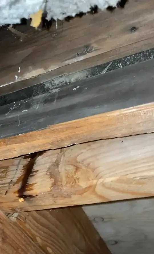

I recently experienced a roof leak on a heavy raining day in the east coast. Picture 1: This is the interior ceiling.
I tore open the ceiling sheetrock and could see that water was dripping from the horizontal wood beams. When I checked with a flashlight between the horizontal beams I can see a tiny hole on the black material (above the beams). Water was leaking from that tiny hole.

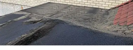

Picture 2 : This is the outside/exterior roof of my building from where the water is coming in.
I am assuming its right under the red shingles but not exactly sure. How do I exactly know where is the leak/hole from outside ? I guess once I find the hole I can patch it up with flashing cement.
Any advice on what is the best way to fix this leak. enter image description hereenter image description here Thanks in advance.

  • I'd agree with jwh20, what is currently there does not look properly done to me. And you shouldn't have standing water, even on a flat roof. I too will say remove and rebuild that section of roof. You can try some silicone to do a temporary patch to at least stop the dripping for now, but do not rely on it long term. – Phaelax z Dec 29 '20 at 18:29
  • @Phaelaxz the best way to "agree" with an answer is to give it an up vote. Since jwh20's answer doesn't show any vote activity (as I'm typing this), then you haven't done so. Go ahead and give him a vote for his efforts & to show your agreement properly. The rest of what you typed could have been a comment on the answer instead of the question. – FreeMan Dec 29 '20 at 18:52
  • Do you have the resources to do it better? Adding some fall to that roof would make it so much better - specially with all the red shingles draining in from the right hand side. Comment because its not answering the question, but does address the long-term need. – Criggie Dec 30 '20 at 08:11
    A littte bit of history...I am the home owner and i dont do construction. This is a 110 year old home which is my primary residence since 2012. 4 years ago i decided to do some addition to the house. The red shingles are where the original house actually ended. The square corner is the new addition. There were no leaks prior to the addition. 2 years after the addition, i started experiencing the leaks, so i called the same construction company, they came over and i think they applied some flashing cement. It was fine for couple of years and this winter i am facing the same problem. – Jay Roy Dec 30 '20 at 15:42
  • The top picture isn't particularly clear, but do you have any boarding on top of the ceiling joists, or is the black sparkly stuff in the photo the bottom of the asphalt/felt layer? – Andrew Leach Dec 30 '20 at 21:28
    Boarding is present on top of ceiling joist and asphalt layer is present on top of it but boarding is missing across the border line of the new addition and I can directly see the sparkly black asphalt layer. That is what you see in the first picture as well. The hole is on that black asphalt right above the water droplet that you see in first pic. – Jay Roy Dec 31 '20 at 01:25
  • That's your problem. There is no shortcut. If there's boarding under the extension roof, where it's sagging and pooling, then that boarding needs to be replaced; the missing boarding has allowed the felt to sag and develop holes. Once that's happened water will get everywhere. Been there, done that. @jwh20 is right. – Andrew Leach Dec 31 '20 at 08:34

Clearly this has been a problem for a while and also the standing water and patch job on the flat section of the roof is to blame.
There is no real shortcut here, as you can see, so the solution is to remove the roofing, repair the water damage, and then have it re-roofed properly. There are ways to apply a flat roof so that it will not leak but slathering it with roof patch is not one of them.

  • "Re-roofing properly" needs to include insulation: if there isn't any, then condensation on the underside of the roof will eventually degrade any boarding, causing it to sag. That will cause the felt to stretch, pool and allow water in. Insulation can go between the ceiling and the roof, or between the boarding and the felt. Or even both. Slathering it with roof patch will help get through a winter, but it's definitely not a permanent solution. – Andrew Leach Dec 31 '20 at 08:47
Your problem is going to be finding where the leak is coming from. I have found leaks that came in more than 10’ from the entry point. The water can travel under the rolled roofing and drip down at a seam then run on the rafters especially double plates prior to finally coming down.
Today I use a FLIR camera I can see the water when it is traveling between boards because of the temp difference.
The only way to patch in wet weather is a patch like Henery’s asphalt or other brands of similar type. I would stick with asphalt as that is the best material and the base of the rolled roofing.
I used to do hot tar as a kid and for patches we used Henery’s you might have the leak up in the valley or to the side that is running down so identifying the entrance point will be the most critical part and sealing that point. Asphalt patch can even handle standing water and most brands I have used can be put on in standing water but you have to work it a bit to get it to seal and it works better on dry surfaces.
I used to use a leaf blower to dry roofs off before sealing it helps.
