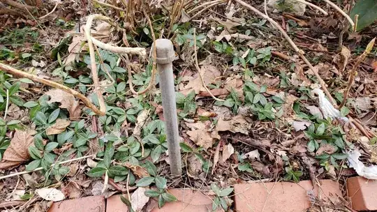

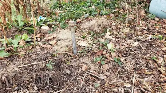

We've owned this home for 5+ years now, and these pipes have been bugging me. Even moreso now that I'm looking to do some landscaping right over one of them.
The house was built in the 60's in a Philadelphia PA suburb. We have city lines for natural gas, water, and sewer. The pipes wiggle a bit with a touch, but don't pull out. They're very firmly capped. 811 hasn't ever marked them when we've had them out before, and I intend to have them out before I do anything, but I want to know if anyone can ID them ahead of time so I can call a specific utility.
One of the pipes is in the front side yard, near the driveway but far away from the street. The other is in the backyard next to our patio.

  • can you go to your gas meter and see if there are any lines other than the ones that go into the house? Then go into the crawlspace/basement to see if any exit in the direction of those pipes? – redlude97 Dec 30 '20 at 20:29
    Also check and see if there are any clues inside your house (crawlspace/basement area if accessible) to see if there are any similar unidentified pipes leaving the basement headed in those general areas. – Milwrdfan Dec 31 '20 at 16:39
    Are these pipes in a line? If so - mentally extend the line and see what's in the path? I presume they run to/from your home, so what's at that point? If the line runs toward the road, what's out there to give some clues ? – Criggie Dec 31 '20 at 23:24
  • They could be old, capped-off sprinkler pipes. – Hot Licks Jan 01 '21 at 00:49
  • But hard to believe they are electrical conduits. – Hot Licks Jan 01 '21 at 00:50
  • Do they run beside a pathway? The brick edging suggests this might be a boundry between pathway and garden, and that could make lighting a distinct possibility. – Criggie Jan 01 '21 at 03:20
    Dirty hack - get an assistant to lightly tap one with a hammer while you listen closely to another one. A sharp `>TINK<` sound might tell you they are piped together under the ground or a dull `_..-tHUd-.._` implies separate as the impact travels through soil. – Criggie Jan 01 '21 at 03:21
  • Stupid question: What is 811? – Hagen von Eitzen Jan 02 '21 at 14:03
    @HagenvonEitzen It's a special short phone number for a service that will tell you all of the _documented_ locations of buried utility pipes and conduits on your land. Very helpful for not accidentally digging into a water main ... as long as the documentation is accurate and up to date. In Pennsylvania I believe it's this outfit: https://www.pa1call.org/ – zwol Jan 02 '21 at 15:00
  • I'm looking forward to seeing your answer, because we have one of those on our Pittsburgh property (I discovered it when mowing the lawn one day). It was loose enough that I was able to push it down further into the dirt and we've more or less ignored it since. – Sean Duggan Jan 02 '21 at 18:48
  • So, any news on what these are / were? – SQB Nov 19 '21 at 07:28

Even though 811 ignored them doesn't mean they are not a private utility. It is possible they are natural gas or waterlines, or were an electrical conduit however they are most likely just pipes driven into the ground as support for a past fence.
To rule out private utilities you can call an HVAC contractor licensed in PA to work on gas (most installers and maintenance companies have employees who are) to come out and verify it. They will likely uncap it and use a special meter to detect gas. If there is water or electrical lines they will be able to tell you and give you guidance on your next steps. They will need access to the home and it will be easier for them and you if you clean out any areas in the home where pipes or electrical lines could be concealed behind exterior walls or crawl spaces on the side of the property the pipes are on.
Absent any utilities, you can dig down to the base or use a pipewrench on the pipe and unscrew the pipe and pull the unscrewed pipe up. If it is welded to a spade or something weird, you'll have to dig down all the way or cut the pipe off below grade.
If you have never worked with natural gas I don't think it would be responsible for you to take any advice walking you through dealing with a suspected gas line other than to call a licensed and trained professional.

It's impossible to tell as these are just generic threaded steel pipe. If this were mine and I wanted to know, I'd dig down and see what's there. That will likely answer your question.

  • Could be anything ; from age and location - lines to buried heating oil storage tanks that are no longer used. It was not unusual to just forget them when nat gas became available. – blacksmith37 Dec 30 '20 at 21:08
  • Agreed - a little bit of spade work could provide a lot more info. If they end in a lump of concrete then it could be a fence, vs if they end in a T junction into another pipe. – Criggie Dec 31 '20 at 23:22
If no underground utilities can identify them then it is very likely they were installed without a permit and so no service has record of their location or for what use. Do as jwh20 suggests and dig down. Their placement suggests they are auxillary water taps.
I had similar pipes all around my 50's era home. It turned out they were taps into water service (between meter and house) placing locations for spigots on all sides of house where there was originally just one located on the wall.
    This feels like the most likely answer, but there is a spigot off the side of the house fairly close to the one by the patio. I'm getting a professional either way to tell me for sure! – Marisa Dec 30 '20 at 20:29

That end cap looks very similar to this.
1-1/4" Galvanized Malleable Iron Pipe End Cap Threaded Ends, 300 Liquid & Gas psi, 150 Steam psi https://www.mscdirect.com/product/details/36990166
This sort of cap is designed to resist high pressures. Whatever is in there, you don't want to risk it coming out in case you can't get the cap back on again.
    That is an excellent point, but does not mean that the contents is under pressure now, or ever was. I can imagine someone selecting a solid product over a flimsier one, and these are decades old by now so have lasted, proving their robustness. – Criggie Jan 01 '21 at 03:19
    @Criggie - I agree but best to be cautious. – chasly - supports Monica Jan 01 '21 at 10:16
As others have said, it's impossible to tell without following the line, so be careful. I've seen unused sprinklers capped like this, and it could also be capped electrical lines for yard lights.
