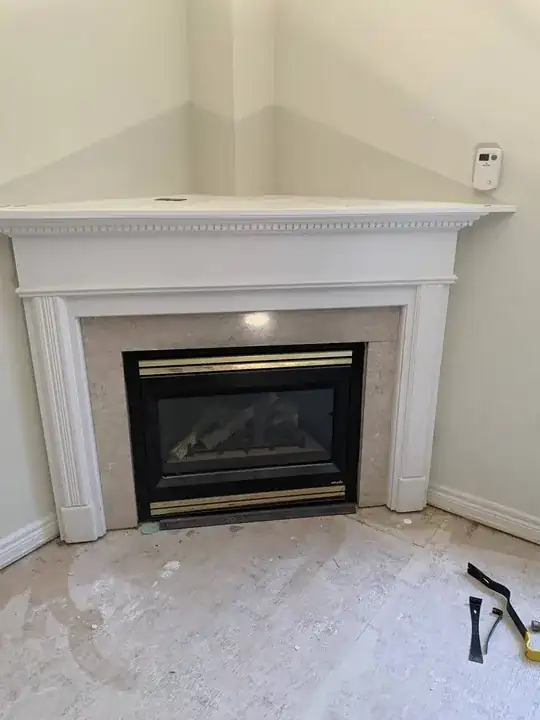

I recently removed a fireplace and added new drywalls to open areas that were behind the fireplace.
I also added drywall tape to the inside corners, and metal corner beads to the outside corner. Only the new drywall areas (and a couple of inches above them) have the new corner bead and tape. I tried my best to make sure the new drywalls and tapes are installed correctly and are even all around... same with the mud work. But, I've noticed an issue with the inside corner on the right side. As you can see in the pictures the bottom side of the corner is not aligned with the top part.
What are my options at this point? Which compound would be best to fix the unevenness and the corner line?
Should I continue on and prime it and see how it turns out? Should I apply some mud to make the line more straight? Should I remove the drywall tape and try again, or add another tape to fix the line?
I'm a beginner to taping and this is really my first project, I've got the necessary tools including a 45min quickset, a different CGS sheetrock pre-mix compounds: multi-purpose, light-weight, and dust control types. I also have some sparkle but I don't think that is helpful here.
And I have the 2", 4", 6" and 12" knives. I've also got the inside and outside corner knives in case they are needed.
Before: enter image description here
