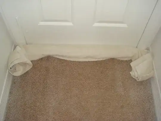

For a temporary, low-cost, low-hassle solution, you could just put a towel down in front of the door to block the draft. That's what we always did in my house as a kid.
towel in front of door
