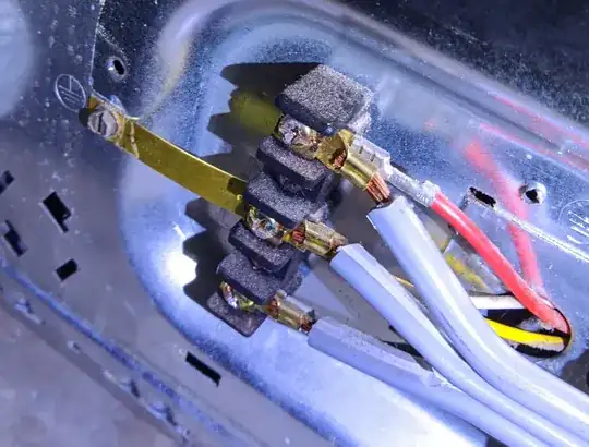

On my GE dryer, a 3 prong cord is hooked up as shown on the picture. I want to replace it with a 4 prong cord I got with the standard green/red/black/white terminals.
I am a bit unsure of what goes where and why the ground is connected to white/yellow with a jumper on the current setup.
How would I hook up the new cord after having removed the old 3 prong one and will I keep that jumper from ground like it is now?

  • The jumper is there for an odd Code section that allowed grounding certain appliances via the neutral conductor. The Code stopped allowing new installations of those 3 wire circuits over 20 years ago. You are much better off changing to a 4 wire configuration. – NoSparksPlease Jan 03 '21 at 04:16

Remove that brass jumper, connect white to the middle terminal, red and black to the one each of the two end terminals and green to the ground screw.

    curious what that extra yellow going to the neutral terminal is. – Erich Jan 05 '21 at 14:27
    If you remove the main cover therer may be a diagram on the back. – Jasen Jan 05 '21 at 18:51
    I will look into what the extra yellow is connected to and report back here. Right now the dryer is running constantly so I am not allowed to open it. – Christian Jan 07 '21 at 15:42

The jumper from neutral to ground is exactly what makes a 3-prong cord so dangerous.
The jumper gets removed. The neutral wire lands on the insulated terminal (that was vacated) and the ground lands on the uninsulated end. I don't know if they provide a parking position for that strap to "live" when it is disconnected, but since 3-prong connections are obsolete and dangerous, I'd be thrilled to see it go away for good.
Really Code requires you to follow the dryer's UL-approved instructions (findable on the Web), however I'm pretty sure that's what the instructions will say to do.

Thank you for the photoshopped connection picture. Very impressive and helpful! Based on that information and illustrations I got here I ended up with what you see in the picture. I moved the ground connection to make it work with the cord I got. It works so I am hoping I did it right. I also hope the used GE dryer I bought will last for a year or two. Thank you all again!

    The way you can tell if you got it right is simple: Unplug the dryer. Use a multimeter to check for continuity (a) between the ground pin and any exposed metal on the dryer (should show continuity) and (b) between the ground pin and each of the other pins (should **not** show continuity). Hot/hot/neutral are pretty much guaranteed to be correct because (a) they are obvious and (b) hard to come up with a scenario where the dryer would work if they weren't done right. Ground is the tricky one - but your picture looks good. – manassehkatz-Moving 2 Codidact Jan 03 '21 at 19:02
    I got out my multimeter and did the tests. According to that I'm good. First load is now going with the new cord. Thanks again! – Christian Jan 03 '21 at 20:49
    Actually that makes perfect sense. The ground strap needs a ground screw in one place, yet typical cord lengths require the ground screw in another place. So two ground screw sites (or as man as 4 that I can see). Nothing wrong with that!!! – Harper - Reinstate Monica Jan 03 '21 at 21:15
    The ground cable is supposed to detach last if the cable is pulled with force (e.g. when someone stumbles over it). so it needs to go to the closest connection point. One of the hot wires slipping out of the wire nut will likely bring it in contact with the chassis, which is still grounded, causing the GFCI to trip. – Simon Richter Jan 04 '21 at 22:29
