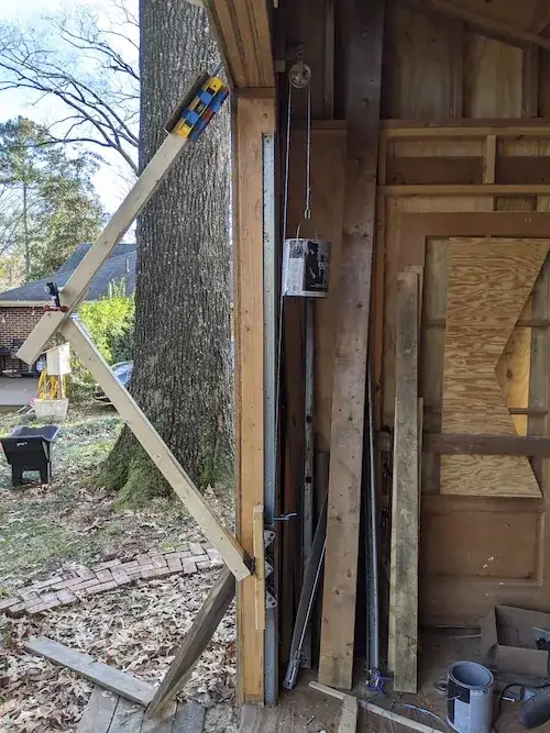

I am designing a counterweight system for a hangar door (folds straight up to open, unlike typical residential garage doors). It needs to have a pulley system with counterweights that exactly equal the weight of the door so it can be opened to any height and stay there. Due to constraints in my wall between the studs, the counterweights (buckets full of sand or water) only have half the vertical distance as the door, and I don't have enough physical space to put twice the weight of the door.

Edit: for those who think I'm just trying to cheat on homework, here's a photo of me actually building this (prototype):
Photo of door pulley prototype

  • The paint can is really for the purpose of simplifying the explanation and the prototype (prototype is actually full of water). I will likely make a concrete form exactly to fit in the stud bay with a piece of rebar through for strength and to make the attachment point. I have several springs but it seems harder to get the spring to exactly balance the weight of the door. I don't understand the advantage of springs. If a cable breaks, the other counterbalance (I will have two or even three depending on what I figure out) will slow the fall of the door. – brentonstrine Jan 04 '21 at 01:24

I see on the photo that the ceiling is quite a bit higher than the door. If you put the pulley higher, then you can have more travel on the counterweight before it reaches the floor, and you can use the same weight as the door.

  • The prototype has room, but the actual built door will have counterweights in the wall with less vertical room. Using space above is a good idea, I was trying to figure that out. Maybe horizontally having lots of weights that travel only a few inches. – brentonstrine Jan 03 '21 at 22:08
