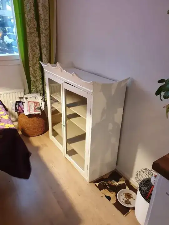

Do you think it possible and safe to hang this cabinet on this wall with no support below it?
It is 38 x 90 x 100cm and weighs something like 30kg, It is intended to fill it with dishes and such so it'll get even heavier. The wall is reinforced concrete.
I've looked around at videos and forums for advice but can't find anything definitive and I don't want to whole thing falling off the wall in the middle of the night.
If it is possible then what are correct type of supports to use? Thanks for any help and advice.

It looks like the cabinet is intended to sit on top of a base cabinet. You are right to be concerned about the structure of the cabinet. You can add a discrete support below it. In addition to the suggestions above I would add a couple of L brackets on the bottom. Cabinet bracket and wall

  • Yes, I think it's clearly supposed to sit on top of a base. I'll see if I can argue my way into another base or table, if not then L brackets look to be a sensible addition! – Ralpharama Jan 06 '21 at 18:58
    Shelf brackets, the ones with a diagonal brace, might be a good idea more than plain L brackets as pictured. Of course they'd go down, not up the back. – Criggie Jan 06 '21 at 22:38
    Upvoted for pointing out that this is not actually a wall-mounted cabinet, but the top half of a two-piece furniture. This kind of construction was popular in the 50s to 60s. I know these from my grandma's place. A word of warning: DANGER! These cabinets are rarely glued. They are held together by the pieces interlocking in clever fashions and can be dismantled by pulling at the back or top. If you hang this the wrong way, it can fall apart (it is intended to). Definitely devise some support. – Hermann Jan 06 '21 at 22:50
    I think this is the only safe way to go. The fact that it is both a deep and tall cabinet means you have significant shearing and normal stress on any mounting points. The mounting bolts will be hilariously large before shearing stress becomes safe on wood. Unless you know, with certainty, the grain of the structural wood, the stress may split the wood open. – Nelson Jan 07 '21 at 00:23
  • yeah, the vertical members in the back of the cabinet look like they are in two pieces, and the side panels may just be thin board. the sides may need diagonal reinforcement to properly support the front edge. – Jasen Jan 08 '21 at 23:12
  • I'd also recommend placing support posts on the outward facing corners, effectively making it a standing cabinet again. – Mast Jan 09 '21 at 11:00

    This answer doesn't really address the main point of the question, which is whether the cabinet can be hung safely. Looking at the images, it's built to stand (sides in compression, back possibly not carrying any significant loads, just ensuring rigidity), not to hang (back and sides loaded in tension and shear). Those are pretty much opposite situations, and as such the cabinet is fairly likely to come apart completely if not built to hang. Discussing which fasteners are best is overlooking the elephant in the room. – TooTea Jan 07 '21 at 15:45
    @TopTea- Nope. You're wrong. – ojait Jan 07 '21 at 15:55
    Yeah, the back panel on this kind of shelf is basically worthless for structure. It's often just a thin piece held in with finishing nails or staples. It keeps the frame square, but definitely cannot support the weight of the rest of the cabinet by itself. Cannot stress enough to attach the *frame* to the wall, *not* the back panel. – Darrel Hoffman Jan 07 '21 at 16:01
  • @danielh-Yeah. Thanks for agreeing with my answer. – ojait Jan 07 '21 at 16:06
    @ojait Any evidence or arguments to support the idea that the cabinet itself can handle the loads of hanging? No offense, but "Nope. You're wrong." does not a convincing argument, make. – mbrig Jan 08 '21 at 06:13
  • @mbig- don.t have to' OP accepted my answer. – ojait Jan 08 '21 at 14:56
    I'm gonna weigh in here too that simply screwing this thing to the wall is a *bad idea*. From the pictures it's clear this this cabinet is not meant to be hung, and due to its high weight plus heavy ceramic load, half-assing this by putting screws through random bits of isn't safe. The woodworking visible from the pictures is rather crummy as it looks like there aren't any proper woodworking joints--simply nails and glue. All the boards are different sized, there are weird cutouts, etc. This looks like an amateur made it, and I wouldn't trust it with heavy things. – Dragongeek Jan 08 '21 at 23:31
    If the OP had to ask the question, using their judgement of what is most safe and most structurally sound as evidence of said soundness and safety, only demonstrates a lack of individual good judgement about it. – Nij Jan 09 '21 at 00:28
    Looks like this will adequately hold the backboard to the wall. The rest of the cabinet will just shear apart though, since it can't handle the hanging load. – Mast Jan 09 '21 at 10:59

    A french cleat is a good idea for mounting wall cabinets, but the cabinet in question looks like the upper part of a hutch which was designed to sit flat on a base. It will likely collapse if hung with a French cleat and then loaded. – Ben Jackson Jan 08 '21 at 03:10
I'm a 62 year old (2nd gen.) custom cabinet shop owner and have a ton of experience in cabinets. I strongly suggest you really look at the back of that piece before you do anything. All the fasteners in the world mean nothing if the cabinet/furniture is built in such a way where it won't support itself on the wall. I think the easiest (not the most nicest looking from the side) way to handle this is simply screw on a piece of good quality 1/2" plywood to the back of that thing. Make sure your screws go into solid wood around the perimeter of the cabinet, top and bottom, left and right sides. Unless you change your mind in the future and decide to place it back on the floor, I'd use wood glue also. Then all the fastener screw recommendations can be used here. If you simply have a 2x4 stud wall, use a good quality 3" long screw and use at least 4 of them to hold that thing up. Once you're done, try to move the cabinet with your own arms. Even try some weight on it. If it's sturdy, you'll know it. If not, the cabinet isn't built well and you should take it down and not hang it. It's that simple.
