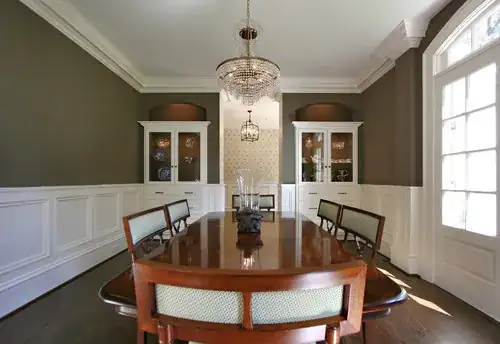

It appears to be just a matter of how you trim it out. You can do something detailed like in the photo or as simple as 1/4 round trim to cover the edge.

  • That's the question, I suppose: how do folks typically trim it out (or maybe there is no typical answer?) – DA01 Dec 07 '12 at 20:03
  • BTW, I love houzz too. Alas, I haven't been able to find a picture of both wainscoting and casing-less windows yet. So, maybe it is rather atypical. I guess that makes sense as sheetrock returns are all about less ornamentation while wainscoting tends to be about more ornamentation. – DA01 Dec 07 '12 at 20:06
