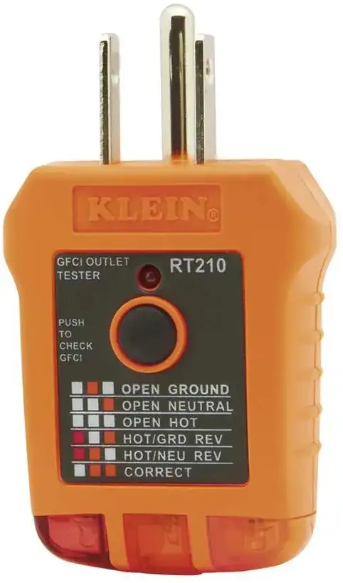

You can get a simple tester like this one: Klein RT210
to test receptacles to see if they are properly grounded (and check for certain other problems as well) and also to see if they are GFCI protected. Note that, ironically, the GFCI testers often do not work if there is no ground wire, because they work by taking some of the current that should be going from hot to neutral and sending it to ground. If there is no ground, then the current doesn't flow - and the GFCI doesn't trip!
    Also, if there is no ground wire, your surge suppressors protecting computers and other expensive electronics will not work, since they use the ground wire to dump the voltage spike to, well, ground. – Jon Custer Jan 11 '21 at 23:50
    Actually, if the previous owner bootlegged the grounds on the outlets, the 3-light testers will give you a false sense of security. – DoxyLover Jan 12 '21 at 01:36
