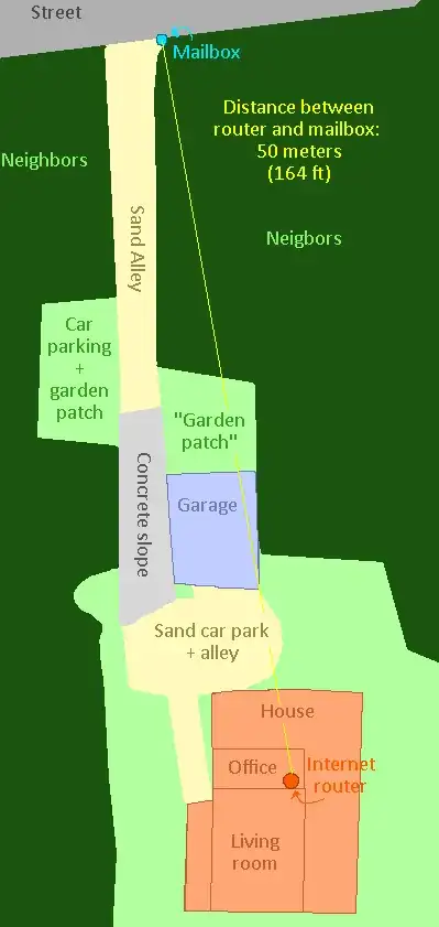

Our house is pretty far away from our mailbox, and we need to walk uphill to go check the mail. The mailman has very variable hours, so we often find ourselves going 3-4 times to the mailbox during the day. My dad is an avid DIYer, and has given himself a challenge: find a way to know when the mailman drops mail in our mailbox. He has thought about a lot of different solutions and none really fit our use case. We looked up online for other people who have done that, but every one seems to use WIFI. Our WIFI unfortunately doesn't reach that far, as the mailbox is quite distant from the house (we measured 50 meters / 164 feet).
He first thought about putting a WIFI camera in the mailbox. However, WIFI doesn't reach that far (the router is in his office, I put it on the diagram).
He also thought about running a cable from the house to the mailbox, attached to a sensor or a camera. However, a part of the path is made out of concrete, and burying the cable would be super hard. He could also run it through the garage, there is a little space between the roof and walls so a cable would probably fit. However, he would then have to drill through the house's walls and having done it in the past, it is a real pain.
He thought about buying a camera or sensor that uses a SIM card to connect to a network that will be picked up by his phone. However, our country forbids the use of SIM cards for communication that is not person-to-person. He would have to get a more expensive kind of card.
He thought about putting a WIFI repeater in the garage, but finds this solution a bit overkill and expensive.
This is a diagram I made of our house configuration using a map:
diagram of our house based on satellite data
We are looking for a solution that is not too expensive and doesn't involve a lot of wall drilling. I have read about people using radio sensors (for instance a tilt sensor on the letterbox door), but knowing nothing about radio waves, we are a bit lost.
What would be an ideal solution to remotely check if the mailman has dropped mail today?

High tech solutions won't easily work here - you could put a wifi extender on your garage that would halve the distance of the wifi signal, but that would still involve cost and effort of engineering a motion detector or some other kind of signalling device and a way of communicating that to the house owner.
I'd suggest something simple - a simple circuit break/light system that will illuminate a light in the house when the circuit is broken at the post box. For this you can get away with thin electrical cable stretching down the lane and into the post box. For the area where the concrete slope is, you can simply caulk it to the side - for the rest, simply bury it a centimetre or so down.
All you'd really need to do is design a circuit that will illuminate a bulb on the circuit breaking, but not in a way that the bulb will go out when the post box is closed (maybe this could be circuit design, maybe by a physical switch at the post box).
    Great answer. To add: 1 - This should be a low voltage circuit - easiest would be to run it off of a doorbell transformer or similar - that way accidental contact by person or animal is not so dangerous; 2 - There are ways (I'm thinking "latching relay" at the moment) to make it so that the light would stay on until you manually reset it. – manassehkatz-Moving 2 Codidact Jan 21 '21 at 15:12
    Or wire up a doorbell and put up a sign that says "please ring when you deposit mail!" – Azor Ahai -him- Jan 21 '21 at 20:01
    @AzorAhai-him- Or rig it up so whenever the mailbox is open it pulls a lever that rings the door bell. – DKNguyen Jan 21 '21 at 21:56
    Thank you very much. This is probably the best answer and the one we will go with. I've read each answer to my dad and this is the one he liked the most. In all cases, thanks to everyone for your participation. – C. Crt Jan 25 '21 at 15:01
    @C.Crt Hope your Dad has fun with this one. Thanks for the feedback, although there's a few good answers here. –  Jan 25 '21 at 16:16
