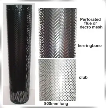

To ensure maximum heat usage I would run it up through the second floor and out the roof there using a single skin flue ( if this is allowable by code and manufactures specs) and a decorative (perforated/decro) flue cover Perforated flue
You can then get ceiling rings to cover the necessary gap around the flue to combustible floor surfaces which will match the decro you choose.
