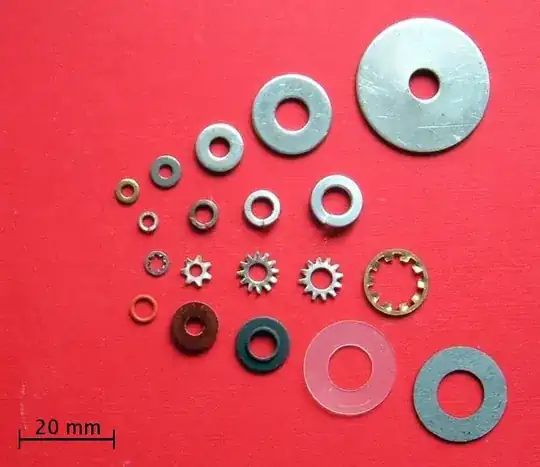

Triple use (as I saw after years of mechanics) :
1) Washers are ofter used to avoid grinding of the support when you screw the nut.
2) Washers avoid the bolt head or the nut to penetrate/damage the support.
3) Washers help things moving in boltened assemblies if you oil them a bit (eg. articulations).
Following Niall C comment : observation and a bit of logic will make you put the washer on the right place, now you know what it can do.
EDIT
There are so many types of washers, i will advice on the more common ones :
enter image description here (image from wikipedia)
Flat washers (first row of the picture) :
  • "Flat not wide" : avoids degradation of the support (paint, ...)
  • "Flat wide" : for pivots, when the pieces you bolt have to move
  • "Flat wide and thick" : for avoiding bolt/nut penetration in not-so-hard supports (pine wood, plastics, ...)
Lock washers (second and third row of the picture) :
  • All types : penetrates the support material in order to lock the bolt/nut and the support
All others types are for specific use...
Benj
  • 179
    This explains what a washer is for, not where it should be placed – Niall C. Dec 13 '12 at 15:35
    Indeed, you are right. I apologize for the inconvenience. Place it where you want it to do the wanted job. Generally, I prefer putting it on the nut side, since the nut has often to turn more than the bolt head. – Benj Dec 13 '12 at 15:40
    One can infer where the washer should be used from this answer, which depends on how you're using the bolt and nut. If you intend to turn the bolt (for clearance reasons or whatever), it may make more sense to use the washer under the bolt head. This answer is more correct than those that blindly assert otherwise. – isherwood Jun 07 '17 at 13:57
  • @isherwood You're right, it's exactly what I wanted to mean when I wrote "logic will make you put the washer on the right place" ! I expanded my answer with some details on washers types. – Benj Jun 07 '17 at 16:39
