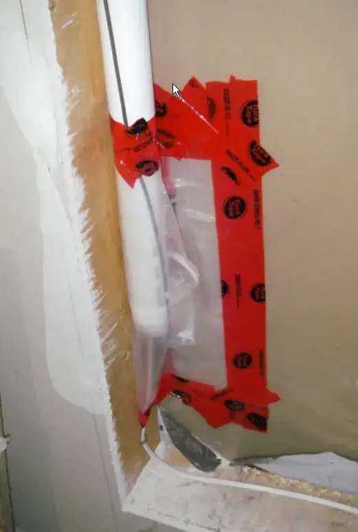

I'm retrofitting a central vac system, and it will be easiest to put a couple of the inlets in the exterior wall between the garage and the house (the vacuum itself is going in the garage). One benefit of this is I have relatively easy access to the wall from the outside, since I can remove the drywall in the garage.
The inlets I'm using are "Electra valves", which means they have 120V power via a pigtail connection, in addition to the low-voltage signal wire. The box is not an enclosed box,
What should I do with the vapour barrier? I am thinking to just form a small pocket around this whole thing, and then tape up the holes where the wires go through, and tape around the 2" suction line. Good idea, bad idea?
While I could locate these on interior walls, it is much less convenient, as I have to come in through the basement and route around some existing pipes, wiring and vents -- I will end up having several elbows and several extra feet of piping (both things you want to minimize in vac systems), and the resulting inlet placement is no better or worse than if I do the exterior wall.
UPDATE: Completed, using the method Paul described. Everything is 6-mil vapour barrier.
I tried to leave as little air in this pocket as possible, despite it being fairly large. I wanted to ensure there was enough room for the wires to move around when attaching/removing the faceplate from inside, which there easily is.
Though it's not apparent in the picture, I used a separate loop of tape going around the wires so there isn't even a gap, kind of like this:

"I am thinking to just form a small pocket around this whole thing, and then tape up the holes where the wires go through, and tape around the 2" suction line."
Seems like you answered your own question. I like that you're being fastidious about the vapor barrier, but I have some questions for you.

Based on the information you've provided it seems that your house varies from cooling to heating needs depending on the season. This implies to me that the integrity of the vapor barrier is of minimal importance.
It has been my experience that condensation problems primarily happen where the air-flow in uninsulated locations is retarded by improper insulation installation. A small (<1 ft. sq.) area where the vapor barrier is nonexistent because of fixture installation is unlikely to be a problem. E.g. everywhere you have an electrical box.
