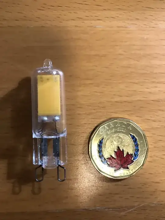

I need to replace a faulty lightbulb but it's not one I've come across before. It's being used in a light fixture in my washroom above the vanity. Can anyone here identify it? I'm hoping I can order one from Amazon or my local Home Depot.
(Loonie for scale)

This is a G9 halogen bulb:
Note G9 is the name of the socket and form factor, but it says nothing about wattage. Voltage should be mains.
Yours is a G9 COB LED:
Since the original bulb uses LEDs, the fixture may not be designed to handle the heat of halogen, so it's better to replace it with a G9 LED bulb. As for wattage, check the fixture, but really you should be able to use a bit more watts like 5W instead of 2W if you want more light, it shouldn't melt... If you put a 20W halogen lamp in a 2W all-plastic LED-only fixture it will probably melt.
Get a flicker-free bulb if you can, they're easier on the eyes. If you use a dimmer, make sure it says "dimmable". Note the LED bulbs don't all have the standard length, so you might want to measure the space inside the fixture to make sure it fits. For example this one is bigger, so you'd have to check.

    Thanks for this! I had no idea LEDs were available for this kind of fixture. We currently have halogen bulbs and they get remarkably hot. – Organic Marble Jan 25 '21 at 15:11
    If you do replace it with halogen, do *not* touch the glass with your fingers when installing it - use a piece of clean cloth or a paper towel. Finger oil deposited on the glass is one of the main reasons for these burning out. (Don't think that's an issue with the LED versions.) – Darrel Hoffman Jan 25 '21 at 18:38

  • We replaced smaller G9 halogens with fatter corn-cob G9s with success. I used https://www.lights.ie/g9-led-bulbs/ which is a German company. – gaoithe Jan 26 '21 at 16:15
  • I wonder whether I could add that I've had enormous problems with plastic-encapsulated LED bulbs in a bathroom, so it's important to get one that- as in the OP's photo- is properly sealed. – Mark Morgan Lloyd Jan 26 '21 at 17:08
  • @MarkMorganLloyd Yeah these are powered from mains without transformer so it is wise to avoid the garbage quality ones where the plastic sheath is not sealed and will come off, exposing the high voltage bits or just letting moisture in... – bobflux Jan 26 '21 at 18:10

It's a "quartz halogen" lamp. You will need the voltage and wattage off of it or the fixture, and that is what's called a "G9 base", which is important to pay attention to because there are several different bases in this style of lamp and that has to match.
JRaef
  • 14,844
  • 39
    looks more like a LED. – Jasen Jan 25 '21 at 08:18
    @Jasen I agree. I'm pretty sure that's an LED with a G9 base. I haven't used my G9 lamps for years because they got too hot. But since it looks like LEDs now exist for G9 bases, I'm eager to buy a few bulbs and use those lamps again. – End Anti-Semitic Hate Jan 25 '21 at 11:53
