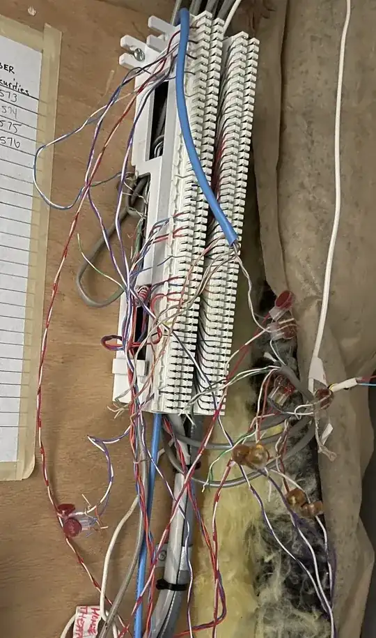

I’m moving into a new house that looks to have Ethernet wired through it though it looks like it was being used for telephone?
I’m wondering if it will be usable for Internet and if so what changes I need to make/what exactly I need to do.
Also is there any way to tell if it’s all cat 5 or cat 5e?
I don’t know much about this so step by step on how to make it work for Internet would be greatly appreciated. So far my guess is that I need to pull all the wiring out of that current punch panel and add RJ45 connectors to each separate wire? At that point I just need a way to connect them to my router?

    the blue cable could be LAN cable ... the rest are probably not ... check the printing on the cables – jsotola Jan 31 '21 at 11:40
  • @jsotola last time I noticed the blue cable said cat 5e though I couldn’t see anything printed on the gray cables. So you’re saying they’re probably not even Ethernet? Or they’re cat 3? – Mark Jan 31 '21 at 12:20
  • The cable should be marked every 2-3 feet, but it may be faint, and it likes to be on the side you're not looking at right this second. Look closely with a strong light. I've installed thousands of feet of gray (riser) 5e as well as thousands of blue (plenum) 5e. Then again, it could be Cat3 after all, but **you can't tell that by jacket color.** – Ecnerwal Jan 31 '21 at 13:35
    None of that stuff looks like Cat 5, 5e, or 6. None of those cable have the suggested number-of-twists-per-inch for Cat 5 and higher cabling. It's possible its Cat3 or 4, but more likely it's just POTS (plain old telephone system). – SteveSh Jan 31 '21 at 15:22
    Most of the wires that you can easily see the twist rate on are clearly cut from a 25-pair cable (based on the colors), and that's almost certainly POTS or Cat3 at best. Telephone folks often untwist pairs, as can be seen on some of the hanging splices. Until you read the cable jackets, you won't **know.** – Ecnerwal Jan 31 '21 at 16:16

Read the jacket - I think I can see, but not make out, faint red printing on at least two of the gray cables in your picture. But there's no guarantee that all the gray cables are the same, if this system grew organically over time rather than having been all installed at once.
Even if it's CAT3, it will run ethernet (slowly by modern standards.) That will be fine for a printer that plugs into ethernet, and other uses that are not too demanding, but won't suit your faster goals - in which case you might examine how it's installed, and whether you can use the current cables to help you get new cables into the places you actually need faster connections.
Your best bet at this end would be to install a patch panel, rather than "plugs on cables" - plugs on fixed cables are iffy (they tend to fail,) while a patch panel is quite reliable, (and also easier to connect to) and helps to organize the mess.
You'll also need a switch, to get the signal from a cable leading to your router to all the other cables (or all the other cables you are actually using.)
Beware that as phone wiring, there's no guarantee that the wiring completely respects a "star" configuration (each cable here leads only one place) - some legs of the apparent star may be "daisy-chained" to more than one outlet, and that does not fly with Ethernet like it does with telephones.
    This answer is correct. That's a phone line terminal. Phone lines don't need star network configuration, so don't expect that ethernet will just work over lines wired for phone. Also, CAT5/e/6 are just fine to run phone signals over, that's what basically everyone does these days. You can pull apart a normal Cat5 cable and get 4 phone pairs. – Gorchestopher H Feb 01 '21 at 15:25

This was clearly being used as telephone wiring. Even if some of the cables are ethernet cables they have been cut and spliced for phone use and there may be splices hidden in the walls similar to what you see here. That's ok for phones. Even if some of them "work" for ethernet they may work slowly. You will not know, you'll just blame your ISP.
My suggestion is don't use any of this for internet. Buy good Cat6 or better cables. Don't buy the cheapest ones on Amazon, but good ones with good reviews. Run cables to a few critical spots in your home from a central location. Buy and install a mesh network with wired backhaul (so the mesh nodes all use your new cables) and buy a small switch if needed to connect it all together.

The grey stuff is often non-twisted pair, or unshielded twisted pair. As others have said, read the label.
The blue stuff could be cat 3 or cat 5, but unless you have access to both ends, it's a crap shoot whether it has a continuous run. You may be able to figure some out by temporarily unhooking wires, and seeing where you have dial tones.

The wiring workmanship shown here, no matter what the cable type is, cannot be relied on to yield satisfactory ethernet operation. The way twisted pairs are untwisted for several inches, with the individual wires crossing other wiring in an uncontrolled fashion... stubs of old parallel connections just left dangling... if it works, it is still likely to cause and/or be sensitive to RF interference. The reason the wires are twisted in a twisted pair cable is NOT mechanical and NOT a stylistic or manufacturing choice.
If the actual intent is running a DSL line to a router, it could work - unlike ethernet, DSL is DESIGNED to work around imperfectly done wiring. However, even DSL cannot always deal with a so called bridge-tap situation that might be present here (multiple lines wired as parallel circuits, even if there is nothing connected at the end of the circuit - all these communications technologies work with RF electricity; the concept that a circuit with no load connected does not matter is NOT true with RF).

    Yes, it's rather obviously **currently** telephone wiring, so there's no reason to expect it to "yield satisfactory ethernet operation" in it's current form. That's also not the question. – Ecnerwal Feb 01 '21 at 02:00
  • >cannot be relied on to yield satisfactory ethernet operation. | yeah, but just redoing the plugs at both ends is a twenty minute task costing a few bucks VS redoing the cabeling which will run you days and a good bit of cash – Hobbamok Feb 02 '21 at 13:58
  • @Hobbamok Putting plugs on the ends of crap wires only wastes plugs and "20 minutes". (Chances are anyone asking this question to begin with has zero to very little experience putting ends on Ethernet cable, so 20 minutes is pretty generous estimate.) Even by some freak chance it works, it won't work well or reliably. It's better to cut the crap out and do it correctly...Both to ensure future compatibility and also to avoid fighting with it. – gnicko Feb 05 '21 at 19:49

Is this part of a SOHO (small office, home office ) DIGITAL phone system? the 2 large cables (trunk lines I think is the term) are a clue it's attached to a KSU. Also, the connectors shown are typically used on phone lines. The smaller cables should have printed on them the type of cable. The blue ones look like cat 5, the grey ones look like cat 3 (not suitable for ethernet). Repurposing some of might be possible. But, and here's the big BUT if the phone lines are not all "home runs" and are daisy chained (common for POTS phone wiring), you can't re-use them. They're also probably cat-3, again, not suitable for ethernet.
All you can do is start tracing circuits. Get some testing equipment at go at it.

    Thanks a lot this was helpful. Previous owner had a law firm so I think it’s safe to assume this was part of their home office. If the cables are anything less than 5e I won’t bother with it regardless as cat 5 would be slower than wifi in my case – Mark Jan 31 '21 at 12:18
    Jacket color is **not** an indication of CAT level - read the (often faint) printing. Blue jacket is (usually) plenum, gray jacket is (usually) riser, and could be Cat3, Cat5, Cat5e... – Ecnerwal Jan 31 '21 at 13:32
