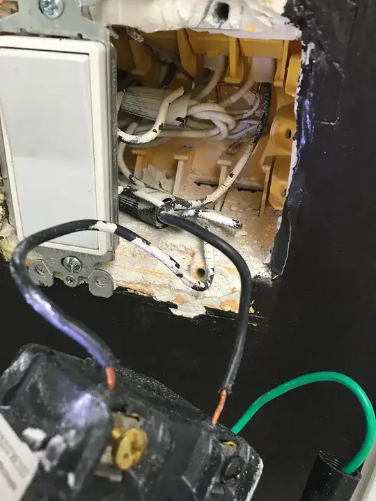

So I bought new outlets to replace the old ones in my house and everything was going fine until I reached the kitchen. The panel switch for this particular plug is split between two (a/b) (if that makes any difference). When I put the new plug in, I can’t turn the switch in the panel on as it trips instantly. As soon as I put the old one back, it had no problem.
Why is this happening? I don’t think there’s any difference between the two of them other than the fact that this ones newer.
Any ideas?
Wiring outlet

TL;DR Remove the tab on the hot (red/black) side
"A/B" plus the symptoms sounds like you have a Multi Wire Branch Circuit or MWBC. With an MWBC, you can have the top receptacle's hot on one part of the circuit and the bottom receptacle's hot on the other part of the circuit. Each receptacle is then 120V hot-to-neutral but the two hots are 240V apart. With the tab removed on the hot (red/black) side, the two circuits are separate on hot but share neutral. With the tab in place (factory default), you have a short circuit between the two hots - 240V at maximum possible current, which quickly (and correctly) trips the breaker.
Remove the tab, only on the hot side, and everything should work.
While you're at it, check the "A/B". There should be a common shutoff - i.e., either they are part of a double-breaker or have a "handle tie" between the two parts. If you are not sure, upload a picture of the breaker panel.

    Ah this makes sense. Thanks for the thorough answer. Also, there’s a handle tie between the two parts in my panel. – ACanadianCoder Jan 31 '21 at 19:02

You need to remove the tab between the brass screws on the outlet. This will separate the two hot feeds.

    But *only* between the brass (hot) screws. Don't remove the tab between the silver (neutral) screws. – AndyB Feb 01 '21 at 04:23
