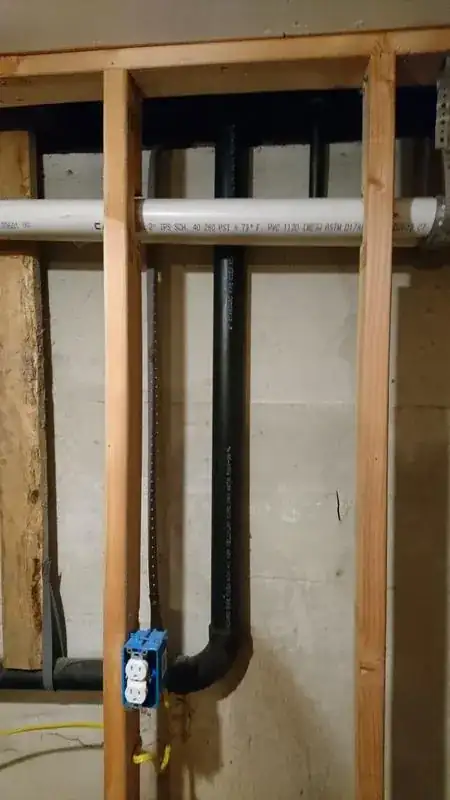

I have a 3" diameter by 4 ft long, vertical ABS sewer drain pipe (unpressurized), in my wall that has a crack running lengthwise for around two feet and slowly getting longer. I've called a plumber to replace it, but he won't be able to do so for 2 weeks.
Since this pipe drains the kitchen sink and the dishwasher, in the meantime it's dripping a lot. I'd like to put a temporary fix in place to reduce the dripping until the plumber comes.
The two main things I can see to use are silicone wrap tape (around the pipe), or epoxy putty (in the crack). Which would you use, and why? Or would you use something else entirely?
Photo of the dripping section of black ABS pipe below. I believe that a much larger section of pipe will need replacement to make it leak-free, which is why I'm having a professional do the permanent fix. Yes, the pipe there does look like an amateur install; I suspect it was.
black abs pipe photo in wall

    You realize that the photo does not show us the critically important part of this whole thing - namely, the crack itself. We can presume it's there buried under shadows somewhere, but the image is doing nothing to help us determine the extent or nature of the failure. – J... Feb 05 '21 at 15:41
  • The crack could also be from torsion - it's hard to say without seeing what it looks like, but an ovezealous tightening under the sink with a grabby fitting could have twisted the pipe and caused the crack. – J... Feb 05 '21 at 15:45

    These repair methods are more difficult than replacing the pipe if it is accessible. @FuzzyChef I suggest you edit your post and add some pictures. – Jeff Wheeler Feb 04 '21 at 20:28
