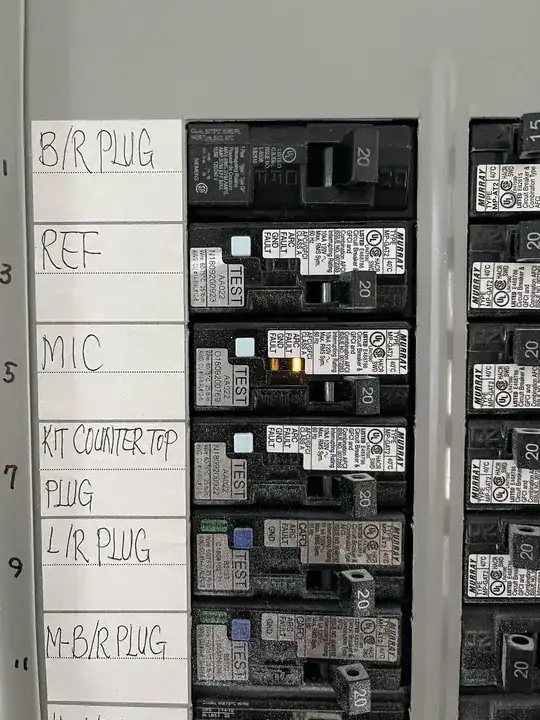

Edit: image of breaker:
Breaker Image

    Which lights on the breaker are turning on? Also, if you put a big microwave-safe container of water in the microwave and run it, do you still get a trip, and if so, how long does it take to trip? – ThreePhaseEel Feb 07 '21 at 21:20
  • If a AFCI breakers causes nuisance trips, Isn't it code legal to swap it with a non-afci? I think it was legal to do that on GFCI breakers, but I'm not sure. Hopefully one of the "big 3" will weigh in. – George Anderson Feb 07 '21 at 22:32
    @ThreePhaseEel I put a 32 Oz bowl of water in the microwave, tripped after 4 seconds when setting it to 3 minutes. – Arian F Feb 07 '21 at 22:40
  • @ThreePhaseEel I've added an image of the breaker after I turn it on from being tripped. – Arian F Feb 07 '21 at 22:45

My breaker version is 2b. The versions go 2b, 3a, 3b, and 3c. Each version has been updated with new sine wave detection algorithms to work with more appliances, having less false positives.
And when you purchase from amazon you won't know version version you are getting. So you'd need to go to like Home Depot and see the breaker in person, here is how to identify which version you have (which is not documented anywhere lol):
  • 2b - No label - 2018 and Pre 2018 era
  • 3a - 2 Green Vertical Bars with Black Line between bars.  2019 era
  • 3b - White label with Black letter N and Down Arrow.  2019/2020 era
  • 3c - Black label with White letter N and Down Arrow.  2020/2021 era
Here is version 3b, see if you can identify the version with the above info:
Siemen Version 3b
