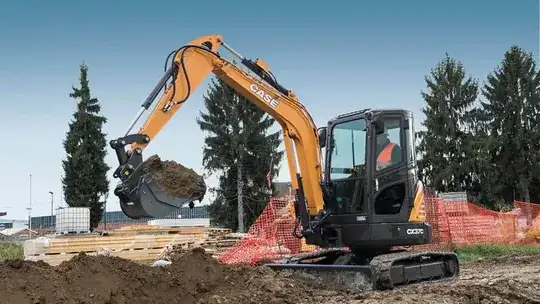

I plan to rent an excavator like this:
mini excavator
I am aware that it is quite dangerous if someone walks by and is hit by the bucket, but assuming I can clear the area of passers-by, what are some common dangers to be aware of that could cause harm to the driver? Can a mis-move of the levers cause the bucket to break through the cage?

    Tip over or hitting power lines are the two cases. Should be stops to prevent bucket/boom from going back to far, unless something breaks. Need to check if any utilities are in the ground first. Most places have free check for utilities before digging. – crip659 Feb 08 '21 at 18:16
    For a properly assembled and maintained mini like the one you have shown, there is no way for the bucket to even contact the cage much less break through it. – jwh20 Feb 08 '21 at 18:40
No, and that is a fundamental design regulation of the equipment you are planning to operate.
