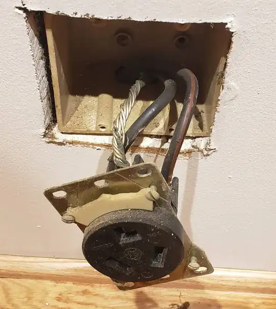

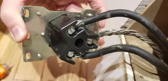

Edit: here are some pictures of the wiring open socket close up of the back
Edit 2: full electrical panel and back of receptacle full panel back of receptacle

    We need to know the size, metal (copper vs aluminum) and insulation type of the existing wires, so we can assure the wire is ready for 40A. We also need to know if there's a metal conduit, metal jacket on the wire, or ground wire. – Harper - Reinstate Monica Feb 10 '21 at 19:36
  • I added some pictures of the wiring. It looks like bare braided ~14 gauge metal on the neutral and rubber-jacketed braided ~12 gauge on the two hots. I was expecting to find copper wire but since it's silver I guess it's aluminum? – 5E4ME Feb 10 '21 at 23:54
  • @5E4ME -- can you post photos that show the label on the inside cover of your panel *in full*, as well as the back of the range receptacle box? – ThreePhaseEel Feb 11 '21 at 00:03
  • @ThreePhaseEel pics added – 5E4ME Feb 11 '21 at 00:21
  • @5E4ME -- can you get us a shot of the inside of the box that shows where the cable enters the box clearly? – ThreePhaseEel Feb 11 '21 at 00:53
  • @ThreePhaseEel apologies, here you go http://imgur.com/a/uvk9KMP – 5E4ME Feb 11 '21 at 01:00

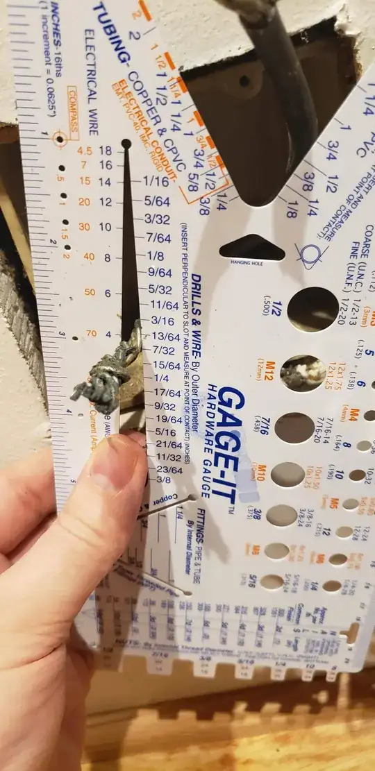

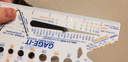

  • @5E4ME -- can you get us the overall diameter of the bare wire? – ThreePhaseEel Feb 11 '21 at 01:19
  • @ThreePhaseEel looks like 4AWG overall for both types of wire comprised of individual 14AWG strands. http://imgur.com/a/i1D6KhG – 5E4ME Feb 11 '21 at 01:33

You appear to have at least 6AWG if not 4AWG aluminum present there, so you will have no trouble with a full-sized range circuit using the existing 40A breaker and a NEMA 10-50R receptacle. Since this is aluminum wire, though, you'll need a Cu/Al rated receptacle, and also to make sure you use anti-oxidant grease on the connection and a torque screwdriver to accurately tighten the lug screws to the specification torque.
You'll want to find a way to run a separate grounding wire back to the panel or the grounding electrode system in the future, though
In the future, though, you'll want to run a 10AWG copper wire from this box back to the panel, or any other point on the existing grounding electrode system, so that you can replace this (hazardous) NEMA 10 with a (much safer) NEMA 14 receptacle and convert your range over to the matching 4-wire (NEMA 14) plug.

    It is aluminum wire and OP also needs to be careful about making those connections on the new outlet. They will need to ensure the 10-50R outlet is rated for #4AWG aluminum and they will need to refresh the anti-ox paste and torque the lugs correctly. Workmanship is very much more important when fitting aluminum. – J... Feb 11 '21 at 14:39
It appears to me that this cable has two insulated conductors for the two hot legs plus an uninsulated conductor to be used as a ground, i.e., it does not have a third insulated cable to be used as a neutral. The cable is wired to the receptacle using the uninsulated conductor as a neutral. This is not allowed by code.
This cable can legally supply 240 V, not both 120 V and 240 V. It is not suitable for any appliance which requires both 120 and 240 V. What are the requirements of your new range?
Unless your new range is a special design which requires only 240 V, you must replace this cable all the way back to the panel or subpanel if there is one. Look at the installation instructions for the range. It should tell you whether it requires a neutral. If it does, then you will need a new (4 wire) cable.
You could use a 3-wire appliance cord and plug it into this receptacle and the range would work perfectly, but if the range requires a neutral, then current will regularly be flowing in the uninsulated conductor. This is not allowed by code.
If the cable had 3 inslated conductors, you could use it as is or you could retrofit a ground, but you cannot retrofit a neutral.

    @JimStewart, what you're missing is that this type SE cable has an uninsulated *neutral* and *no ground*. It's probably the only type of cable that does not insulate the neutral, but it is designated for use as a neutral by code nonetheless. – Nate S. Feb 11 '21 at 17:44

The #2 problem is that a junction box can't just have a hole bashed in it by smashing a rock against it. The cable entering it needs to have a proper cable clamp, which means the box needs a proper knockout.
The cable is #4 SE cable, and that cable can do 2 interesting things: First, that bare wire actually does get to be a neutral wire. (or a ground, your choice). And second, it's good for 55A generally, but since it can run at 75 degrees C, we can actually get 65A out of this wire (but not going into that old 60°C panel; we'd have to pigtail to larger wire outside the panel).
Aluminum is fine at these large sizes, but only if the receptacle is rated to attach to aluminum wire! (remember; that's what caused all the trouble in the 1970s!) What's more, I would be very surprised if a 30A receptacle was rated for #4 wire, since it only needs #10 copper (or #8 aluminum if it accepted aluminum). So I am suspicious as to how the wires were attached to the NEMA 10-30 recep.
The size is #4. The size of the individual wire strands is irrelevant, as you cannot use the wires individually. At all. The only purpose of stranding is to increase the flexibility of the entire wire. You must not remove some strands to get a wire to fit a too-small connector.
If the receptacle is not rated for aluminum, or not rated for #4 wire, replace it with one that is. That shouldn't be hard with NEMA connectors.

That cable appears to be type SE cable, and so it would be allowed by the exception to NEC 250.140 to replace the 30A receptacle with a 3-wire NEMA 10-50R. Below is the code section you can read. It seems to me your existing installation fits the conditions, even condition (3) about the uninsulated cable.
It would be better to upgrade to a 4-wire, but not required.
Reading the section below can be confusing, understanding of Code terminology is critical. "Grounded Circuit Conductor" is what is commonly called the neutral, and the "Equipment Grounding Conductor" is the ground.
250.140 Frames of Ranges and Clothes Dryers. Frames of electric ranges, wall-mounted ovens, counter-mounted cooking units, clothes dryers, and outlet or junction boxes that are part of the circuit for these appliances shall be connected to the equipment grounding conductor in the manner specified by 250.134 or 250.138.
Exception: For existing branch-circuit installations only where an equipment grounding conductor is not present in the outlet or junction box, the frames of electric ranges, wall-mounted ovens, counter-mounted cooking units, clothes dryers, and outlet or junction boxes that are part of the circuit for these appliances shall be permitted to be connected to the grounded circuit conductor if all the following conditions are met. (1) The supply circuit is 120/240-volt, single-phase, 3-wire; or 208Y/120-volt derived from a 3-phase, 4-wire, wye-connected system. (2) The grounded conductor is not smaller than 10 AWG copper or 8 AWG aluminum. (3) The grounded conductor is insulated, or the grounded conductor is uninsulated and part of a Type SE service-entrance cable and the branch circuit originates at the service equipment. (4) Grounding contacts of receptacles furnished as part of the equipment are bonded to the equipment.
