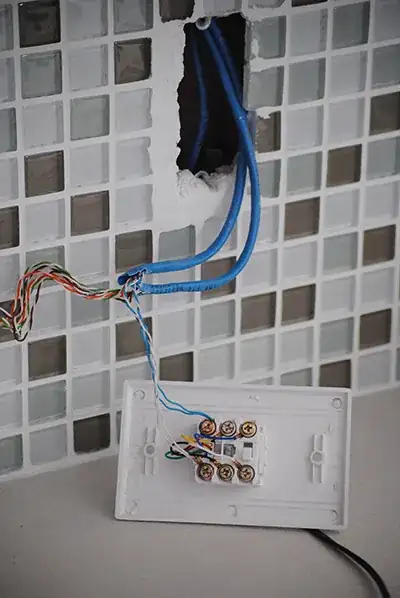

I'm experiencing some noise on my phone when it is connected in the wall. There's no noise when connected right in the modem. So I decided to check things out and I noticed something that seems odd to me. My telephone jack uses 2, yes two, Ethernet Cat 5 cables.
Telephone Plug
(source: max-worlds.net)
As you can see, both blue wires are connected to red wire on the telephone jack and both white/blue wires are connected to the green wire. It seems like an odd setup to me. This is a new house. On a side note, I'm thinking they could have done that to allow an Ethernet network, but we already have a Cat 6 network going on...
So I'm wondering if this is a frequent practice, a recommended approach or a bad job.

    ANSI TIA/EIA-568 Category 5 Telecommunications Cable. Developed for phone/data communications and adopted as the transmission medium of choice for UTP Ethernet as it carried a signal better than Category 4. What you're seeing is not two phone cables, but a single one stripped out so one twisted pair can be used in a daisy-chain loop. Common practice. – Fiasco Labs Dec 19 '12 at 19:10

Probably you have two or more phone jacks daisy-chained together. One cable goes to wherever the phone line enters the house and the other runs to another phone jack somewhere else in the house.
This is a common practice. I did some pricing online, and it seems that Cat 5e is comparable in price to 4-conductor phone cable, so the builders may simply have used it because they had it to hand.

    You beat me to this answer. It should be noted that this was common practice for wiring phone lines in the past. – Craig Dec 19 '12 at 17:42
    It still is pretty common. There is no need for analog phone lines to be run in a home-run config, it is cheaper to daisy chain since you use less cable.... and most builders are cheap! – Steven Dec 19 '12 at 17:57
    Thanks, it makes sense. I dug up a photo of my house under construction and there's indeed a cable going to my basement and one going to my room upstairs. I will leave that as is. Thanks again! – Maxime Morin Dec 19 '12 at 18:06
