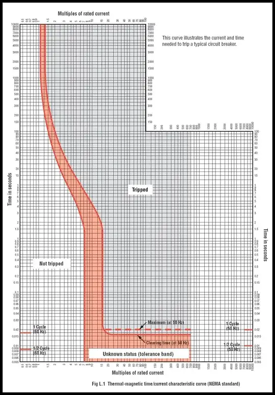

It's to limit the time it takes for the breaker to trip in the case a failure less than a dead short. The time curve for all breakers aren't identical, but suppose the unit fails and it draws 30A, which is 5x rated current. A 15A thermal-magnetic breaker that trips on an inverse time curve (see below) should trip in less than a minute, a 20A breaker could hold for 5 minutes. That heat could be the difference between replacing components and replacing the whole thing.
The unit itself may also have some internal protection less than 15A, but 15A is the smallest size the NEC recognizes in electrical panels.
I've seen the chart you referenced above, I think it still had the source, but it is completely inaccurate for AC circuits and modern wire insulation. I suggest you consult some online voltage drop calculators (1 2 3) to see the actual loss, less than 5% is good, 3% is better.

  • If I read that chart correctly, the breaker will allow up to 7 times the rated current for up to 1.5 seconds in the "not tripped" state, then enter the "unknown status" (during which it _might_ trip, or _might not_) for about another 5.5 seconds (to 7 seconds total time), then will be guaranteed to be "tripped". Additionally, it could take a spike of up to _700 times_ its rated capacity for up to 15 thousandths of a second before being guaranteed to trip. Is that correct? – FreeMan Feb 19 '21 at 19:30
  • That's how I read it. The 700x reflects tripping up to the AIC rating within one full cycle. The 7x seems to explain why motors with overloads are allowed 250% rated breakers to handle inrush that reportedly can exceed 20x rated motor nameplate. – NoSparksPlease Feb 20 '21 at 02:44
  • Wow. That's quite a range and is totally not what I would expect. Granted, 0.015 seconds really isn't very long in the grand scheme of things, but 140 amps for 7 seconds seems like it could allow a fair bit of heat damage to the wiring. I would guess that it's within spec for what the wire is designed to handle, though. ``. Thanks for the info! – FreeMan Feb 20 '21 at 14:32
