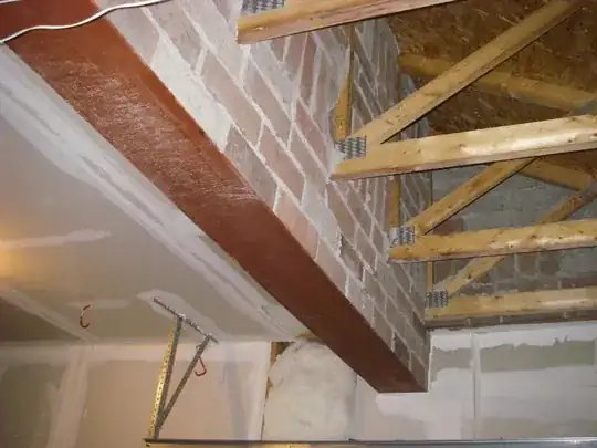

The hole I cut is right next to the brick wall, in the far corner:
Looking up into the hole, opposite the bricks.
In the above picture (looking towards the back of the garage) you can see a heating vent that runs across. There are two vents in the front of this room (next to the brick wall from the first picture), and more vents that run through the ducts themselves. Presumably I'll have to build a bulkhead at the back of the garage for this, but the rest of the ceiling can still be raised.
The electrical you can see is for two lights and a plug on the ceiling for the garage door opener -- all easily moved.

I'm in a temp range about 5C more in each direction. Attached garages tend to be about half as cold as outside so a thermal break is less important here. It wouldn't be a huge loss if you just screwed the gypsum board directly to the underside of the floor joists. However, it's easy to get a thermal break without much more effort, and it's almost as easy as applying directly to floor joists.
After applying the main insulation, sheath the bottom of the joists with 1/2" polyiso (polyisocyanurate) insulation board -- your thermal break. Then using longer screws, apply the gypsum directly to the joists through the polyiso.
Highest possible ceiling, thermal break if you want one, level application, no faffing about with hangers. Wins all around.
bcworkz
  • 11,428
  • I like this approach, but I would go with two layers of polyiso and staggered joints. Note that in most jurisdictions, you need 5/8" drywall between garages and living spaces. – Eric Gunnerson Jan 25 '13 at 05:30
    Yes, that would be even better. At some point, one tends to reach a point of diminishing returns for cost vs. benefit. That point is unique to each climate and pocketbook. Good point about 5/8" rock. And not just any rock, but Type X fire resistive gypsum wallboard is usually required. – bcworkz Jan 26 '13 at 00:11
