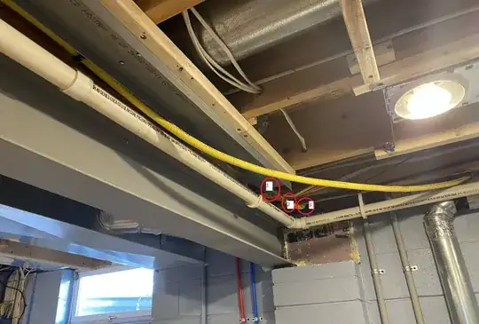

I'm finishing my basement ceiling which includes building a bulkhead around ductwork, plumbing and two CSST gas lines. When the house was built (2002) the contractors used just enough of the CSST to get from point A to point B pinned to the underside of the ceiling joists. For the most part I'm able to tuck the lines inside the bulkhead for the length of the room, as opposed to having them run just above the drywall. Everything would work great if one of the lines was just a bit longer. (See attached photo.)
Shouldn't I be able to splice in 4-5 feet of CSST to make it fit? Information seems scarce on this but some sources seem to say (according to codes) that you can't "splice" CSST gas lines -- that it has to be one continuous run. That seems odd but I can't find anything saying that splicing is just fine. I know my stuff when it comes to carpentry, plumbing and electric, but have no experience with gas lines. I'm not opposed to bringing in a professional to make this happen but wanted to see what options are available. Any help greatly appreciated!
I need the CSST line to follow the path of the white PVC drain pipe.

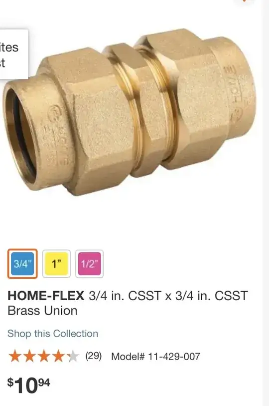

I don't know if spliced joints meet code.
However, physically splicing CSST is clearly trivial, as even big box stores list brass unions with ¾"x¾" and ½"x½" sizes. Here's Home Depot's ¾"x ¾" one:

Quite honestly I would be much more worried about:
  1. Bonding - I don't see a clamp; hopefully it's just out of sight!
  2. Too much jacket removed- instructions state to remove only 2 valley's worth
  3. Kink? That bend radius looks far too tight. Don't try unbending it though, you could make things worse.
MonkeyZeus
  • 16,461
  • 59
  • I very much appreciate your answer and additional input. Overall, I wanted to see if adding just a smidge of line would require hiring a pro. I take the answer to be a resounding YES. I suspected as much but wanted to make sure. Regarding your other points... Sheathing does seem jacked up. I wonder if the code changed since it was installed. Also, I've never been able to locate where the system has been bonded. Both of those reasons have underscored the need to call in someone who knows what they're doing. Regarding the third point, the line isn't kinked. That's a shadow. Thanks! – LeftHandLuke Mar 14 '21 at 22:15
  • @LeftHandLuke Adding a smidge of CSST line is a trivial amount of labor. The real question is whether or not you're equipped to properly test the two new points of failure after performing the work. I'm not sure what code has to do with following the CSST instruction manual. Even stainless steel can rust so the more of it you have covered by the yellow jacket, the better. There is zero benefit to exposing more than necessary. The installer and inspector apparently didn't get that far in their thought process. – MonkeyZeus Mar 15 '21 at 12:34
