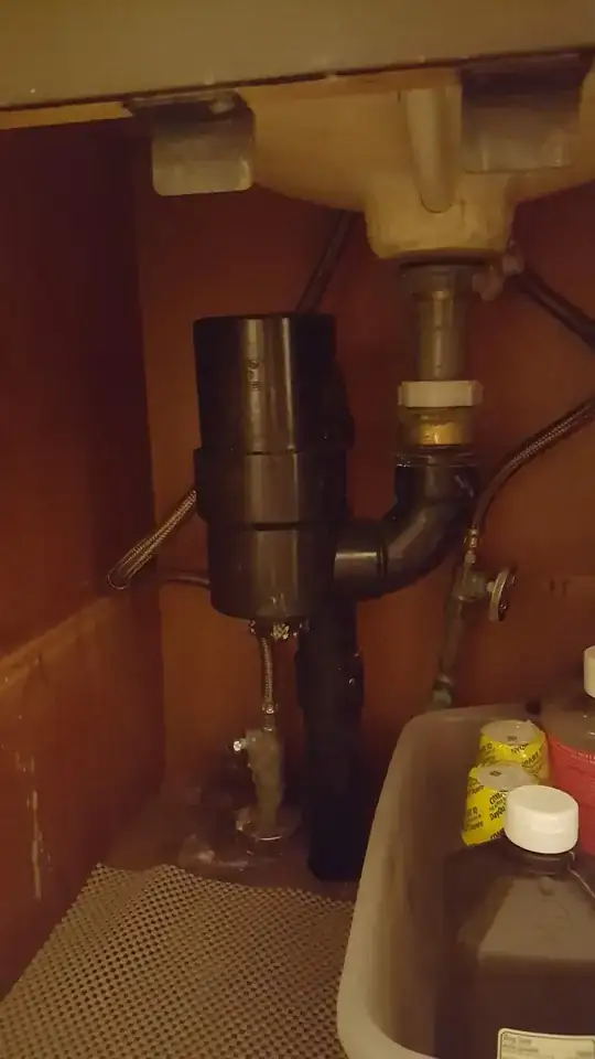

A bathroom sink is draining very slowly after someone bearded shaved, despite them gathering most of the hair out of the sink. I expected some hair to be clogging the J-trap, but when I went to clean that out, I found there is no J-trap and instead the sink drains into the lower end of a cylinder, with the cylinders outflow on the top. Pictures below. It looks like a garbage disposal to me, but that doesn't make sense because this cylinder is not directly connected under the sink and also it is not powered.
I think the cylinder might have the same purpose as a J-trap, given water enters it low and has to rise up high to drain out. That would mean there is (always?) standing water in the sink's drain pipe, at the same height as the cylinder's outflow pipe, because how else would water leave this cylinder.
My question is: what is this cylinder, and how to I clean it out like a P or J trap? I thought to unscrew the base of it since it has the square bottom to grip and turn, then catch what drains out and use a stick to poke out remaining gunk. Figured I'd ask here first, and may also try plunging or poking around the sink drain itself first to see if that solves the problem. Thanks.

    BTW- What you _would_ have there, if it were not for the drum, would be an `S-trap`. A `P-trap` would exit the back of the cabinet and into the wall. While I suppose `J-trap` does get the idea across, it's not a common term that I'm familiar with. Of course, I'd never seen nor heard of a drum trap, either, so what do I know... – FreeMan Mar 03 '21 at 16:17
  • Depending on pipe size, (the downward drain pipe does seem to be bigger than the sink tailpiece, which is good for this) it might fit the "one-pipe" setup which "looks like an S-trap but actually isn't" (the bigger drain pipe supposedly can't get full enough to siphon) but **my** local code forbids that part of IPC anyway. – Ecnerwal Mar 03 '21 at 16:21
18
That is a drum trap. [Evidently also called a bottle trap in some parts of the world, per comments] They are rather old school, and out of favor in code now.
I'm more used to finding them embedded in a floor with the clean-out on top (for a tub application) but yours does seem to have the cleanout down.
Fair warning - they seem to be above average at "wicked gross" - since it's slow, not stopped, I'd run some bleach solution through (1 cup to a gallon) wait a while (if not urgent, overnight - if urgent, 15 minutes or so) then run a couple of gallons of clear water to rinse out the bleach, then put a big catch basin under it and put on gloves before opening it up.

    In my experience that is a BOTTLE TRAP. – MikeB Mar 04 '21 at 08:45
    @MikeBrockington I think it's a US/UK terminology thing. I was thinking "bottle trap" too – Chris H Mar 04 '21 at 14:36
    As the blockage is at least in part hair, I'd try a caustic soda (lye) based drain unblocker before opening it up. Always rinse well between and after chemical treatments, and before getting your hands in there – Chris H Mar 04 '21 at 14:38
    I've had a bunch of drum traps and I'd recommend getting rid of it if possible. They are a nightmare in my experience. – JimmyJames Mar 04 '21 at 15:28
    Do NOT combine bleach and lye. Just in case that might seem clever - it's really not. One or the other, not both at once. Chlorine gas is bad for your life expectancy. – Ecnerwal Mar 04 '21 at 18:04
