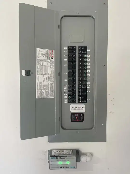

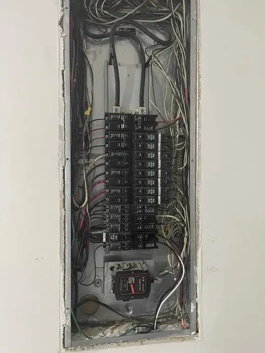

I am replacing the top two of those two pole breakers in the top left (green) with one quadplex with common trip model EATON BQC220220. Is the attached wiring diagram right(just follow the dots color where wires will go / interconnect)? I really appreciate the help
I need to make room for a 50 amp double pole breaker for the generator that will go to the top left after the quadplex install.
I will also add a main breaker in the empty space with the proper interlock. I do have another main breaker outside.

    The plumbing pipe fittings (white PVC) leading to the lower surge device (exterior to the panel - I see you have two surge devices in play) are not code compliant. Conduit and plumbing are not the same. Also looks like there's not a full conduit path into the bottom of box. – Ecnerwal Mar 03 '21 at 21:26
  • Hi Ecnerwal. Great observation. I removed the CHSP ULTRA surge protector as it performed very badly. I instead wired the Siemens on on the breaker that the CHSP was on. Does it make sense? – John Whicker Mar 03 '21 at 21:33
    @JohnWhicker why do you have two surge arrestors? – jay613 Mar 03 '21 at 21:33

Your panel labeling specifically lists the BQC type breaker, so that's alright.
Your wiring (one pair in middle, one pair outside) is correct.
The breaker appears to be "common trip, both inside and outside" so that is either correct or overkill for your circuit, so that's fine. (Beware Eaton "Non-common-trip" types).
However, your panel is labeled for BQC breakers only in certain places depending on whether the bus stabs have a forked tongue. The label is not specific as to where that is in your panel, but given that it's a 30-space panel and the old CTL limits were 40-space, I'm guessing it's the bottom 5 rows of spaces. Which are mostly populated already.
Might be time for a subpanel
As you are seeing, 30 spaces/40 circuits is inadequate for a modern house. A better use of 2 spaces might be to feed a subpanel, so you can offload some loads into that.
If you had any thought to having a "critical loads" subpanel to support future generator or battery/gen/solar backup system, this would be a good time to think about that.
Normally I recommend a house finish with about 50 spaces, so by that a 12-space subpanel would suffice; however, since your house is so full already, I'd aim for more like 60, suggesting a 24-space or 30-space subpanel. Scrimping on spaces is a futile gesture; the price difference is tiny compared to the frustration of - well, you know exactly, don't you! You spent more on that BQC breaker than the price difference would've been for the last guy to buy a 40-space panel instead of the 30. So why not? Spaces are cheap, make the sub a 40-space. Never run out of spaces again.

Yes you have the proper locations / positions with the proper dots. Good question with pics and explanation well above many that are asked +
The only question to ask wou be if your panel is rated for tandems/quads
  • Many thanks. I tried to do my home work so one answering can follow. I strive to do my best Sir. This is a Cutler Hammer Pub 26542 panel and I was advised by them on taking this approach so my assumptions is that it does. How could I very that expect taking their word? THANK again – John Whicker Mar 03 '21 at 19:36
    The panel may have had. Number like 30/60 this would be 30 full sized locations or 60 tandems or a mix in between. If the factory gave you this info I would trust og it looks like there are tandems in the bottom section already. – Ed Beal Mar 03 '21 at 20:02
  • Thanks Ed. There is a big white label on the inside door, would it say on that? What do I need to look for? And yes it seems the bottom 5 slots do allow tandems as I have few small ones already. – John Whicker Mar 03 '21 at 20:07
  • This is the Label Ed, not sure ot 30/60 is there :) --> https://imgur.com/a/fwist3f – John Whicker Mar 03 '21 at 20:20
  • I managed to put all my pictures on the same post. Still learning the ropes LOL – John Whicker Mar 03 '21 at 21:03
    The label does say, just not in the most intuitive way. Your tandem is a type BQC, and if you look at the picture of the bus stabs on the right side of the label, you can see that those breakers are allowed in positions where the bus stabs have a notch, and not in positions where it doesn't. – Nate S. Mar 03 '21 at 21:08
  • Thanks so much Nate. So based on your comment replacing the 2 x two-pole breakers (top lef) with a quadraplex breaker is a GO and the wiring is correct? Thanks for confirming gents – John Whicker Mar 03 '21 at 21:21
  • @JohnWhicker, maybe. You'll need to pull the existing breakers and see if the bus stabs are notched in that location. If they are, you're good to go, but I think it's likely Harper is right that only the bottom rows of the panel have the needed notch. If that's the case, you'll have to rearrange things and put your new quad breaker in the lower section. – Nate S. Mar 03 '21 at 21:52
  • Thanks Nate. Yeah for sure the bottom 5 allows tandem as I have few there. The EATON folks actually advised me to replace the 2 top left ones so I hope they're right LOL – John Whicker Mar 03 '21 at 22:09
  • John, a 30/40 would be more common and that would allow the quad in the bottom and then move things around. The 50 in the bottom right may not have long enough wires to reach the upper locations but it is legal to splice wires in the box and take them to the other side up higher if the wires are not long enough. Since the left side is packed with tandem some moving around will be needed. – Ed Beal Mar 03 '21 at 22:35
