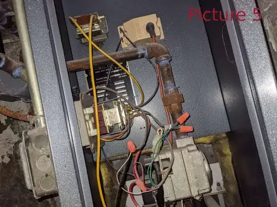

Supplied saddle valve never sat well in my stomach, even before I read up while preparing to install. Inserting a SharkBite T-valve into hot (leftmost in photos) pipe was questionable for a 1st time plumber, so I settled on cold water intake. Supply ¼"-line was long enough, so I wrapped it around the 6" pipe feeding hot air into the humidifier (which I also added), and even put insulation on it past that point. This air pipe (and whole top of the furnace) gets really hot, and water trickles slowly, so my thought was this setup should help to warm incoming water at least a bit :). Looking at photos I see the line sits on the plastic air-valve collar, maybe I should raise it up and tighten around the steel tube to maximize heat transfer? But that collar gets pretty hot too..

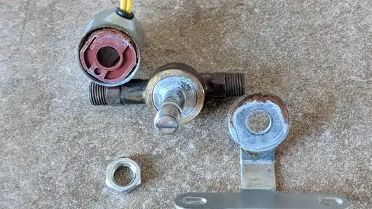

Since the water pad gets a lot of calcium build-up (it's flipped upside down in the photo) we figured same may be happening inside the solenoid valve too, so let's clean it with vinegar (5% acidity). Surprisingly, vinegar removed .. bronze coating on the outside (?? bonus points for explanation please!).
After assembling everything back together solenoid valve worked quietly for a ~day. And then buzzing came back.

A picture is worth a 1000 words, so: enter image description here enter image description here top of the furnace hot and cold water pipes, solenoid valve before cleaning, humidifier open solenoid valve after cleaning solenoid valve after cleaning

While waiting for replacements I tried disassembling the original valve, but couldn't get past removing the coil (see last photo). Flat screwdriver started to damage the slot, so I abandoned the attempt for now. I'm still interested in the internal construction, so will file off two flats on the bolt to clamp it in a vise.
