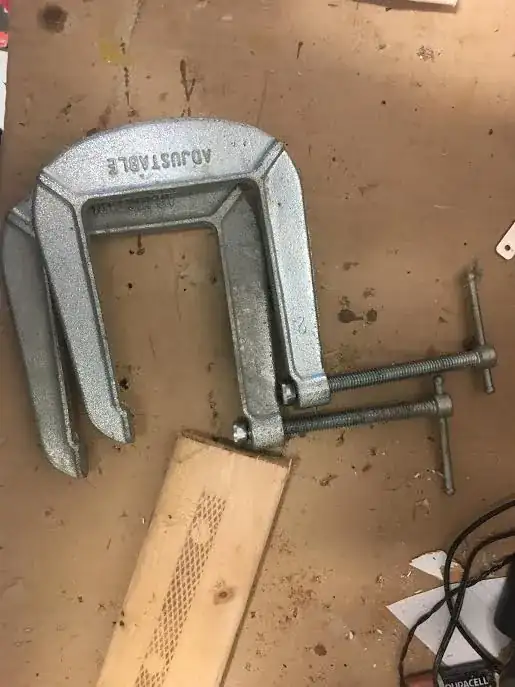

For this you will need a pair of deep C clamps and a board. Here is what I found in the garage. Clamps must be deeper than your microphone stand clamp. Board should be wide; probably wider than this one.
clamps and board

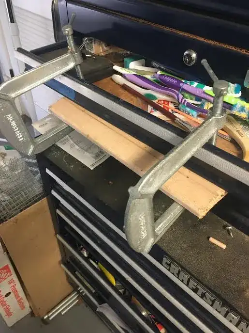

Clamp the board to the underside of your table. Here I used the brush drawer to stand in for your table edge.
clamps and board
Your clamps will be off to either side and not interfere with your microphone stand clamp in the middle. You will be out the cost of clamps, but these clamps will be useful for many years after you are done with the microphone and stand. You will not need to put screws into your table.
Put some cardboard under the clamps so you don't mar the tabletop.
Final result is the effectively the same as @jsotola solution. Downside is the expense of clamps. Upside is no screws or modification to table itself.
