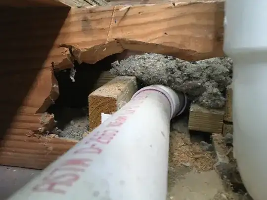

After removing the sub floor in my bathroom in order to extend the sewer pipe for the toilet (it's too close to the tank-side wall), I found that the floor joists have extremely large holes cut in them to make way for the plumbing.
What are my options for reinforcing them? I don't think I could do a sister joist both because of the plumbing running through the joist and because the joist runs quite a ways through the floor of my second story, and adding a sister joist would involve taking up a ton of the floor.
Should I brace it with steel bridging? I'm concerned about the potential vertical load.
What options do I have?
The room is approx 74" by 105" (the 105" runs in the same direction as the joists, it appears that the joists are at least that long, but may extend beneath other rooms) Joists are 15/8 inches wide, 71/2 inches tall. There is a 1st floor bathroom below. There is a tub in the 1st floor bathroom bordered by 3 walls - one of these walls runs perpendicular to the joists 4 feet away from the wall shown on the right in the first picture below.
holes in joists
You can see in this close-up that the furthest joist is completely missing it's bottom: close up of hole in furthest joist

The toilet rough in appears to have completely cut through the joist so there is no connection and it has been blocked to the side joist with a single 2x4 and a single nail.
You likely want to get a structural engineer to specify a prescriptive fix for this. A site visit and prescription is likely to cost less than $1,000 and be well worth it.
You might be able to sister with steel that is shallow and could sit above and below the plumbing penetrations and not need to be sistered the full length of the joist.

I would sister 2 pieces 3/4" marine grade Plywood Braces (since it's under a toilet) on one side of the damaged joist as shown below. Use Epoxy or Urthane glue and SS deck screws to tie them to the Damaged Joist. After both Sister Braces are set and in place, add a plug (not shown) in the gap of the Brace A's (purple) opening since it'll be under compression.enter image description here
Then trace the joist's opening and make a rough cut plug. Glue this in and fill in the gaps between the plug and the joist with a "filler type" resin.
Finally add 2 more Sister Braces (not shown) like on the first side.

    This would be good if it were just 1 or 2 joists, but it sounds like this goes on for quite some distance, that's a lot of floor removal, plugging, and sistering. Might be necessary though - but not a task I'd want to take on myself. Time to call in some pros? – Darrel Hoffman Mar 08 '21 at 19:15
    I would make the purple and blue braces in two strips each , one with a notch and the other continuous. this way they will both better able to resist bending. (brace A continous strip at the top, wider braces with a notch below, brace B like that but the other way up) – Jasen Mar 09 '21 at 03:28
    @DarrelHoffman The damage only spans the portion shown. I looked under the subfloor and the rest of the joist appears to be intact. – Jordan Mar 09 '21 at 15:01
    This answer is missing the critical specification of **how long** to extend the sisters on the main joist. Did you calculate anything to come up with this solution? Or is this a guess? I think either you suggest using a listed product to repair this OR you provide the engineering calculations to prove that it's a valid solution that meets the original strength specification of the joist. DIY structural engineering is what got OP into this situation to begin with. – J... Mar 09 '21 at 20:22
    While this does appear to be a "good idea", I agree with @J... that without the math and SE's stamp, this is just a "good idea". Sadly, "logical" only goes so far with inspectors, permit issues and insurance companies. – FreeMan Mar 10 '21 at 12:51
  • @FreeMan Yep. Even if we had calcs, it doesn't matter - no stamp, no insurance. It's pretty cut and dry. – J... Mar 10 '21 at 13:30
  • What J says, absolutely. Calcs, or blatant overprovision, or its meaningless – Stilez Mar 10 '21 at 13:47
  • Better to make pieces A and B half the height, and install one above the other. – MikeB Mar 10 '21 at 16:19

I would draw attention to the issue that the entire joist system is at risk. Just like parallel joists can reinforce each other, if all are weak, that shared strength may not be dependable. So I'd take it seriously as you are doing.
1) Sister using steel C channel:
Sistering the joist with some C shaped steel channel with an appropriate round (not rectangular! see below) hole cut through it. You'll have to break and re-make the plastic pipe to do this, but that's relativrly easy - PVC cement.
The idea is that C channel will lie with its back (the web) flat to the joist, so it can be very well secured to it, and torque (twisting) won't be a point of weakness.
The C channel wouldn't have to be very thick. It needs a stiffness more than or equal to the joist's original strength for safety and wood is very limited stiffness compared even to thin structural steel.
Theory:
In steel constriction, be it "I" beams (RSJ), C shaped channel, or rectangular tube (RHS), the strength is provided by the flanges (the top and bottom parralel surfaces) not so much by the web (the connecting part between them).
The idea is that as the beam takes on its load, it flexes, and the flexing means that the 2 parallel surfaces have to stretch at different rates. The thicker the top and bottom flanges, and further apart they are, the stiffer the beam.
Steel takes a lot of force to stretch, so it resists the load well. But this also means that provided the hole is of a size that the channel keeps its shape (which this looks like it will do) the web is very much secondary - which is why I suspect a hole even of this size won't matter to it,provided the steel is firmly fixed to the joist along its length and top and bottom.
In fact, the web's main job isn't to resist load. It's to keep the 2 parallel surfaces aligned and separated in their original position so they would have to stretch under load (thus resist it), and can't just move closer or twist instead.
Note as Jasen says in comments that its important to cut rounded not crude/rectangular holes, to minimise stress and weakness in the steel, which naturally arise much more at cut and sharp corners.
2) Reinforce above/below using steel angle:
You could also place steel angle along the length of the joist above and below the pipe. If that's attached really firmly to the joist so it can't pull through the wood, in theory that would work.
I honestly would have real reservations about this, because whatever you use to secure the angle to the joist, wouldn't have to pull much through the wood at all, over time, to allow the joist to sag. It doesn't have the needed overall stiffness, because the top and bottom aren't held in a fixed position against each other, unlike C channel that innately resists flexing even with a hole in the web.
This would be the simplest, but also my absolute least favourite of the 4 because of that concern.
3) Remaking the joist system to avoid the issue:
You've exposed the joists and clearly are somewhat comfortable with heavy DIY. Alljoists will need fixing anyway. So this might be one other solution, depending on the masonry and other structure of the property.
The joists in that room run "left to right" in the picture. If the property allows and has suitable load bearing walls, one could prop them all either side of the pipe/s (use timber under them so they stay aligned), cut them either side of the pipe, and put doubled or very heavy duty joists running "front to back" parallel to the pipe. Then attach the cut ends of the old joists to your new ones using ordinary joist hangers. Essentially youd be stopping all of the the joists at one side of the pipe and starting them again 200 mm/8 inches further,on the other side of the pipe.
This would work very well, provided there is structurally sufficient bearing for the extra joists at the front and back. While that would not be in the design of the property, the load would spread down through those walls at 45 or 60 degrees, along the ground, so support may not be a huge issue. You might need to ensure good bearing at the top.course of brickwork (engineering bricks below the new joists?) and you'd definitely need to check with an engineer for this. But if they agree, its definitely cheaper to do than steel and any builder could.do it.
4) Move the darn pipe:
Vertically in a box conduit in a corner, outside, wherever. Just reroute the pipes and then replace or sister the damaged joists.
Cheapest and probably simplest of all the 3 I'm sure would work.

I have dealt with this in older houses that have had water damage in a location in a bathroom.
Basically you will need two things with maybe a third:
  1. You need metal sleeves around each of these. You need an engineer to sign off on how big they need to be and you might need to search around because the size of your hole is quite substantial - or possibly need to be custom made. (might try to fill cavity before the sleeves but... to do that you don't want to take out more)
  1. You need to sister each of these with 2x lumber at the exact hole size.
  2. You may need to strap underneath with metal which could bring down the ceiling height in the room below by an inch or so.
I would get an engineer to sign off on it and I would sue the plumber or withhold payments. This is really insane.
I have no idea what the other answer are getting at but this is really your only option unless they make you get rid of the joists (or make joists useless by installing others. Depending on the span it might be cheaper to throw a small I beam across there - depends what is in the way and all that good stuff. Answer I gave you is how you have to repair this, it doesn't qualify as saying that repairing this is good enough.
To clarify #2 - sistering might include that section, up until load point (going to nearest wall and making that a load point) or the entire joist (then you might as well install a small i-beam). I have had engineers tell me to sister to a load point to meet building code and then the city tell me that all joists must be run to "main" load point - guess they are future proofing in case of renovations. But as mentioned in comments if you just sister this section, there are sleeves (some cup the bottom) that hold up large building structures so holding up a residential joist is not a big deal. Now is it cost effective if each sleeve costs $300? I don't know.

    I'm unsure about these, because the sheer length of the hole, and lack of thickness above and below, means essentially there's no web to brace the flange and stiffen the steel, and the fact its in 2 parts means there's much less strength against pulling through the timber sideways under load - and a few mm is enough to sag. It would be a solution but my least preferred of several. – Stilez Mar 10 '21 at 09:24
  • @Stilez Yes, those braces are listed, but they have to be installed as directed, meaning the hole they guard must not exceed the size of the cutout. This is why DMoore noted they would probably need to be designed specifically for this application, as specified by the SE. – J... Mar 10 '21 at 13:30
  • @Stilez - These sleeves for sure will work. Now it may cost a fortune to make and install because engineer wants 1/2" of metal but assuredly the remedy works. It would actually the only way to keep the joists and meet building code. Is the thin sleeve in my picture good enough... I don't know. I don't know the structure of his house and how much load this joist is to handle or how long it runs. – DMoore Mar 10 '21 at 15:40
    @DMoore Definitely the product in the image is not suitable. The holes in OP's joists are too large. Most of the screws that should be hitting good wood to secure that brace would be landing in a big empty hole - missing screws = missing holding strength. It's a good idea, but it would need to be a custom designed piece - much longer than this one so that it can get a good anchor on the existing joist. – J... Mar 10 '21 at 17:18
  • @J... - your comment is redundant as I have already hinted at that in my answer. But there are products that look almost EXACTLY like this but thick gauge and longer that an engineer will OK. Given neither of us know the floor layout or load standards for this house we can only guess. This is for sure the only way to fix the joist without running a new one. As mentioned he might need a custom sleeve which may cost a boatload of money (x3-4). – DMoore Mar 10 '21 at 17:26
  • @DMoore I was directly responding to `Is the thin sleeve in my picture good enough... I don't know.`. That one definitely is not. – J... Mar 10 '21 at 17:52
It looks like you'll have to replace that toilet pipe into a higher location, (using a street elbow at the inlet end should give you about two inches more height, using 3" pipe will give even more)
For fixing the joists it will be tricky, a beam notched half way through has only one quarter of its original strength. you basically have four options,
Agressive sistering (but you don't need to sister the whole length and this can possibly be done from below)

Well, it's almost a year later so I'll fill you all in about how I fixed it. The city inspector insisted that I couldn't sister the joists or repair the hole. I ended up taking up the rest of the floor and replacing all of the joists in that room. It ended up expanding the job into the adjacent bedroom and the landing at the top of the stairs. I had to take out part of the ceiling in the room below the landing in order to get the joists under the wall (as seen in the photo).
It was a hell of a job, but it's safe, sturdy and to code; and I learned a lot doing it. I finished the whole renovation about a month ago and the bathroom looks great now.
Big thanks to everyone for the advice, which was a huge help in getting me started learning about possible solutions :)
