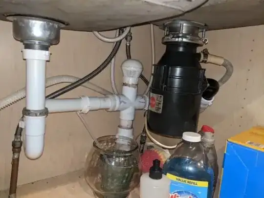

Understand this is asked often. Each case is different though and have not found someone with my plumbing configuration (see pictures).
So when we turn on garbage disposal we get water shooting up non-disposal side just about every time. I am almost sure it is not a clogging issue. As a test I filled non-disposal side sink entirely with water and pulled plug, observe no water backing into garbage disposal or garbage disposal side sink (i.e. it is going down drain quickly). I am convinced this is one of those "garbage disposal shoots with great velocity, takes path of least resistance, goes up non-disposal drain".
I have attached pictures of my plumbing.
Based on all I have read it seems the disposal drain needs to tie in using a T-Baffle to force the waste to go down and not shoot across the 4 way connector. If you look closely a lot of the pieces are glued. I don't think I can get that 4 way connector out without cutting.
What would be the best solution? Some sort of check value in the non-disposal line?

Replace that 4 way junction with two wyes offset from each other (you might drop the disposal trap a few inches to achieve this) and extend the aav arm as high as possible.
The pressure from the disposal may be forcing the aav shut, and between the poor configuration of the hub and the resultant lack of venting the opposite sink is the path of least resistance.
Yes you will have to chop that monster out. If you can't configure two offset wyes at least get a double wye hub and raise the aav.

Get rid of that double trap setup and that PVC tee monster. Configure a single p-trap to a waste ell on the vertical waste pipe coming out of the floor. A baffle tee goes to the top of the trap with the garbage disposer dumping into the top of it and the other sink plumbed into the side port of the baffle tee. Do not use any of that flexible accordion type fles anywhere in the system.

    Tee goes after the trap. If you can make it fit vertically I prefer this to my suggestion. Might be hard. The top of the baffle T has to be below the elbow out of the disposal. The trap beneath the tee. Then the exit from the trap should join the angled part of a wye that will go up to the air valve and down to the waste. – jay613 Mar 11 '21 at 12:38

Et voila. This is what you should aim for, but where I drew the red circle you'll replace the wall tube with another tee that goes up to the vent and down to the drain. Turn the disposal around as pictured here. Use drain tube just as pictured here rather than gluing anything then it's easy to align everything and you don't need a cleanout.

Apologies for the mickey mouse sketches. There are lots of CAD gurus here who would rightly shame me for this .... but anyway .... top is what I believe @JimmyFix-it intends. I think it's the better suggestion. Bottom is roughly what I've suggested. Shaded in the top diagram, two baffle tees, and in the bottom, two wyes offset vertically. Yes there's an AAV either way. Try to shove it up between or behind the sinks as shown.
Either way you should add a cleanout, which I forgot to draw. If you use compression drain fittings for the baffle tees you don't need to add one, but if it's all glued up you can add a straight compression fitting between the AAV and the tee it joins.

  • Looks just like mine. Except I have disposal T/Wye below the non-disposal sink T. In your original response you said to drop the disposal drain. So I figured this meant it would go lower. – M Schenkel Mar 11 '21 at 13:17
  • Two sad souls without CAD skills. :(. Yes you drew my solution correctly, ha ha, the disposal should connect below the sink. Partly because you'll find it easier to stack it that way in the limited vertical space. But you should have added a vent to the other solution, and it has to go after the trap. You could use a wye instead of a tee for the trap/vent connection, if you have space. The benefit of using a tee in Jimmy's solution is that the disposal enters it vertically. – jay613 Mar 11 '21 at 13:21
  • Also with the single-trap solution from Jimmy Fix It you can rotate the disposal around so you don't need so much pipework. You may even be able to put the disposal elbow DIRECTLY into the top of the first tee. – jay613 Mar 11 '21 at 13:27
  • Thanks - you have been most helpful. So both could work. So with your solution if I have limited "vertical space" to work with I could make use of the double wye? – M Schenkel Mar 11 '21 at 13:28
  • One more thought. If you have an unfinished basement beneath this there is a way to vent this through the floor without an autovent. I don't have a preference but some people prefer to not have a mechanical device. As long as you are ripping it all up, have a look. Look up "island sink venting" for diagrams. – jay613 Mar 11 '21 at 14:00
