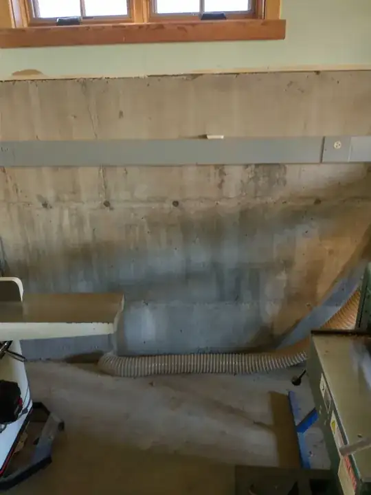

  • When I built my shop and later my house, when I had to deal with sloped land, I just put up taller stem walls and backfilled to them (with proper waterproofing and drainage), saved the cost of additional excavation, building a retaining wall, etc. Since then parts were "Earth sheltered", it stayed very cool in the hot summers but held heat in the winter. – George Anderson Mar 12 '21 at 14:55
  • @georgeanderson do you have a picture of what you mean? – LeopardSkinPillBoxHat Mar 12 '21 at 21:56

I have to post this as an answer, because SE doesn't support pictures in comments. So here goes. I deleted a previous comment bc it no longer applies. On the first pic you can see the tall stem wall from the outside, it's about 5' tall, tarred and then delta dimple mat applied, drain rock next to the stem wall to a foundation drain, backfilling as the drain rock was brought in. Been here 15 years now and have never had a drop of water come into the shop thru that wall. Like I said before, keeps it cool in the summer being partly Earth sheltered and somewhat warmer in the winter. I like my shop at about 58-60 degrees and mother Earth does a pretty good job of that. I may not be comprehending your issue correctly so this could all be worthless, at anyrate, here are the pics:
Pic of tall stem wall
Interior pic of tall stem wall.
