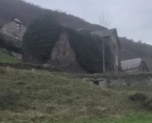

We are renovating an old property in France where three walls of an old stone schoolhouse (10ish meters high I'm guessing, maybe more in some places) sit adjacent to the more recent house (1950s). We need to demolish the walls for a few reasons. 1) They present a safety hazard. 2) They block the view. 3) We want to create a large terrace in its place. Two of the walls are not attached to anything, but the third wall is attached to another house--abandoned and not ours--by a kind of short stone bridge which complicates matters further. This wall is not destined for demolition, but it is, of course, attached at the corner to the long wall.
We've brainstormed a few ideas for how to do this safely.
  1. Climb up a ladder, starting at the top and chiseling away at the mortar, thus allowing us to knock down the wall stone by stone. This seems dangerous and slow.
  2. Attach grappling hooks and use a winch to pull down the wall. This seems more efficient and safer for the people involved but more difficult to control where the stones fall. EDIT: No longer considering this given rebound issues: 2
EDIT: Solution 3: use a hand winch and attach to the top stones with a metal band across several stones and then pull down one layer at a time.
We want the stones to fall inward to fill the void where the old foundation used to be and NOT outward risking rolling down the mountain and into other houses.
Anyone have any idea how to approach this demolition? Are we on the right track at all? Any tricks, advice, etc. you could offer?
EDIT: Many have commented below regarding the legal issues involved like protected/historical sites as well as adjacent property considerations. Thank you for thinking of these issues, but we are approaching everything legally and going through all the proper administrative channels (demolition authorization, etc.). France is super serious about these issues, and we don't dare do anything that would jeopardize our neighbors or our project goals!
Picture below is looking up towards the walls which are now covered in vines.

    I would suggest that the first step is to contact the owner of the other property to let him know what you're going to do. At some point, the wall crosses the line from your property to his, and I'd imagine that you have no legal right to tear down the wall on his property. You may need to hand disassemble the wall along the property line at a minimum, to ensure you don't have any impact on the "not yours" property, should the other owner not be amenable to a tear down (or not locateable). – FreeMan Mar 12 '21 at 14:34
  • Thank you, FreeMan, for your response -- there's no legal problem here because we own all the land surrounding the house that isn't ours, and the connection between the house and the old wall is actually on our property and not technically legal. But we do want to be careful, of course, not to damage the other house. These issues get sticky in the French countryside because property is often bizarrely divided over the years . . . we know who the owners are (the house is abandoned), but it's difficult to get responses from them. – LeAnn Mar 12 '21 at 15:10
    20m/60+ feet high? This sounds rather in the realm of hire competent (and insured) help. – Ecnerwal Mar 12 '21 at 15:13
  • I'm sorry! I mistyped. It should be 10 meters. I'll edit to correct. – LeAnn Mar 12 '21 at 15:16
    The lower edge of my roof is "only" 6 meters or so. Its a long way to the ground from up there, still. Brief use of large equipment by competent operators to knock this down (and then you can make the choice of cleaning it up from a safer location yourself, or exploiting the equipment more) would be a good deal safer than creative DIY "knock-it-over" schemes. – Ecnerwal Mar 12 '21 at 15:25
  • Is there a road and flat surface in front of this wall where a machine could park? – Matthew Mar 12 '21 at 16:05
    Matthew -- if you mean immediately on the other side of the wall from where this picture is taken, no, there isn't. it is a very uneven surface, covered with the debris from the old roof and 4th wall that have fallen in the past. However, above and across from the wall, there is a road. In the picture, the road runs along the other side of the wall you can see in front of the house in the upper left of the picture. – LeAnn Mar 12 '21 at 16:28
  • Your property looks like it could have a septic tank and drainfield. I’d check to make sure I knew the location of all utility lines, including sewer and water before you disturb the land or drop a ton of rocks on utility lines. – Lee Sam Mar 12 '21 at 19:59
    This seems like a perfect opportunity for sledgehammer jenga. Loser gets an ambulance! – DMoore Mar 12 '21 at 20:49
    You have good answers -- Big machine or work platform. Youtube is full of videos that will convince you not to use ladders or grappling hooks (which could act as sling shots) to do this! This is my favorite: https://www.youtube.com/watch?v=Q0hFUfVbGz8 – jay613 Mar 12 '21 at 21:12
    The local laws might not permit the demolition of old structures such as this, may need a permit first. – Polypipe Wrangler Mar 12 '21 at 22:01
  • #1 is slow, but #2 is the dangerous way to do it... "sling shots" +1. #3 would be rent a machine. #2 is out of the question, so you're either up on a ladder (which is where I'd be), or shelling out big bucks and screwing up all the grass. – Mazura Mar 13 '21 at 01:59
    If the site is old enough - it may count as Historic. Need to check with the local council/authority that there is no historic classification here. – Criggie Mar 13 '21 at 02:31

I would say you need a track drive excavator that has a bucket with a grabbing thumb.
You would use the excavator to grab and place the "debris from the old roof and 4th wall that have fallen" so that the excavator can have a stable place to operate from.
The excavator's bucket/thumb can then be used to systematically dismantle the wall.
For a better understanding of what i am suggesting you can watch this YouTube video on building a stone wall to see an excavator at work. (I am available to come to France, s'il vous plaît. I am a handy man.)

    You should be able to rent one from a rental company. Do NOT grapple and pull down with a hook, there is a risk that the hook will tear through part of the wall and rebound to where the tension is being applied (ie. you). – Arluin Mar 12 '21 at 23:04
  • Grapple hook is off the table! Thanks. Will use a strong metal band (don't know the proper terms in English since I'm dealing with French speaking workers) – LeAnn Mar 13 '21 at 14:38
The approaches below can be utilized to perform the demolition efficiently and safely.
If available, a lifting machine can let the worker access the top of wall efficiently and safely. The photo below is a "man-lift" (so called in the US), usually available through construction equipment rental companies. the equipment has varies size (length/high of reach), and working load allowance. You could pair it with a mobile crane, equipped with basket to hold and lower the removed stones to the designated location on ground. The stone can be loosened by a power chisel, then removed manually.
If the man-lift is not available locally, or is undesirable, you can erect scaffold and build working platform on it. But the use of crane is still recommended for safely and effectively removal of the stone. This approach allows more workers work together at the same time, so could be more preferable.

  • This was indeed our first thought, but getting this type of machine to the location would be rather difficult. Access is limited. – LeAnn Mar 13 '21 at 14:39
  • If there is a rental company nearby, check with them for accessibility of the machines. The newer model is getting smaller each day (some can travel on 4' wide path). Mobil crane is more bulky. You can use an additional man-lift in place of the crane, though preferred. – r13 Mar 13 '21 at 14:56
  • @LeAnn Some can handle very rough terrain, with very long reach. Be aware that the longer the reach, the more bounce there will be at the end though. – SomeoneSomewhereSupportsMonica Mar 14 '21 at 10:51
