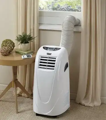

An alternative option is a portable A/C which sits on the floor and exhausts out the window using a vent tube.

  • Yup, these fit just about anything. I've got one of those behind me because there is a solar screen on the window and thus nothing can be mounted outside. – Loren Pechtel Mar 13 '21 at 04:03
    I've got one of those portable ACs. It really pays off to add another duct for the air intake so it doesn't depressurize the room and suck hot air in. – bobflux Mar 13 '21 at 11:30
  • Where does condensation go in this portable AC units? – RonJohn Mar 13 '21 at 11:49
  • I'm not sure what I'm looking at here. Is there a hole in that window frame? If so, why is there a hole in the window frame? If not, where is that tube going? – user2357112 Mar 13 '21 at 12:19
    @user2357112supportsMonica it is a plastic piece that comes with the A/C unit. Open your window slightly, put the plastic piece across the opening, and fit the exhaust duct in the hole in the plastic. I used one of these for years in a similiar situation with small windows that wouldn't open enough for a proper window unit. Not the most efficient setup, but does the job – psubsee2003 Mar 13 '21 at 12:36
    @RonJohn The condensation is usually collected in a tray at the bottom of the unit, which requires any of: manually emptying when the unit detects that it's full and shuts off, a tube to allow the condensate to be evacuated to somewhere else, and/or the portable A/C to be designed to flow unconditioned air over the condensate tray in an attempt to re-evaporate it into the room. I'd note that there are also units which can sit outside, rather than inside, but those are much more likely to be stolen, as the expensive portion is outside, obvious, and not secured. – Makyen Mar 13 '21 at 19:43
  • And if you do get one of these; make sure you get one which actually has the capability of adding a second duct (or a split duct) - the regular single-duct units take air from inside the room and put it outside - the same cold air that you want _inside_. – Jonas Czech Mar 13 '21 at 20:32
  • @RonJohn depending on the amount that needs to be removed, most of it can go through the exhaust vent. That's how mine works, and I've never needed to empty it. – Lawnmower Man Mar 13 '21 at 20:43
  • I really can't recommend these. They work better than nothing as an "AC of last resort", but the efficiency is absolutely horrible, 1) because they "depressurize the room and suck hot air in." as bobflux mentioned, and 2) because you have the compressor and fan motors inside your home, whose waste heat exhausts into your interior, and not outdoors. See this for more details: https://www.youtube.com/watch?v=_-mBeYC2KGc – Alexander Mar 13 '21 at 21:04
  • @LawnmowerMan you must live in a *very* dry region. I'd be emptying that tray at least once a day... – RonJohn Mar 14 '21 at 03:00
  • @Alexander I agree that the single hose units are teh suck but I have a dual-hose unit which is not too bad. Of course, like all engineering, it is a set of trade-offs. When it comes to goofy window shapes, the portables offer the most flexibility. – Lawnmower Man Mar 14 '21 at 06:01
  • @RonJohn well, I live in the PNW, which gets lots of rain. ;) But it also has a low average dew point, so nothing like FL. Remember that the hot exhaust air has a much higher capacity for water than the cold indoor air and even the ambient outdoor air. Because of thermal efficiency losses (e.g., compressor heat), I believe the exhaust air will theoretically always have more excess water capacity than is lost by the cold stream. – Lawnmower Man Mar 14 '21 at 06:04

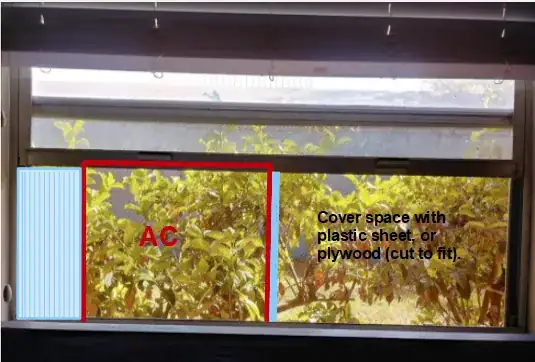

Picture below may help. Masking tape may help to keep the plywood in place, if it is your option. Also, you can use rigid foam (wrapped in plastic) at the bottom to level the window track.
