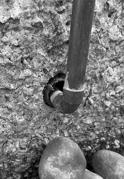

Outside:
elbow, copper pipe

  • I also added a pic of the external copper 90 degree turn. – paul_h Mar 21 '21 at 14:23

  • I added a pic of the elbow - @K-H – paul_h Mar 21 '21 at 14:22
  • @paul_h Saw your pics. Putting the drain valve where the elbow is outdoors is probably your best option as mentioned in another answer, but is that sleeve hole into your house not properly insulated and sealed? You should look into that. – K H Mar 22 '21 at 04:01
Water in pipes tends to use gravity. It doesn't like to go uphill. It appearss that the tap outside is higher than the pipe feeding it. In order to drain that pipe - which obviously didn't happen, but needs to - there needs to be a cock at the lowest point.
If that's where the elbow is, that needs changing - a T with a cock will do. Otherwise, if the pipe goes lower inside the house, then the cock needs to be in it there.Then, you can drain the whole pipe, with the inside valve closed, and the outside tap open.
