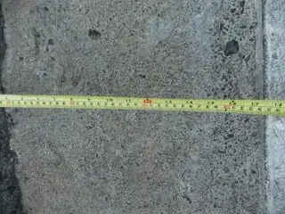

I have a low car and the ditch between my driveway and the street is pretty big. I usually enter my car in reverse at a very steep angle as to not have it scrape the lower front. My neighbors park cars pretty much around the driveway and it is sometimes not easy to get in at such an angle as not to scrape. I would like some suggestions I can do on the curb itself to alleviate this problem.
The drive way is about 14 feet long. The ditch is about 18 inches (between the driveway and street) and 3 inches deep.
The street is slightly higher than the driveway. If I get a chance, I’ll take a picture with a level.
More pics
enter image description here enter image description here enter image description here enter image description here enter image description here enter image description here
More neighbor examples
