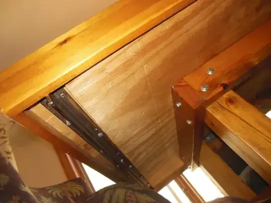

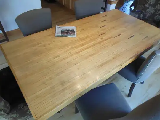

I made a large kitchen table from maple bowling alley with the arrows. 42" x 84" My alley boards were nailed together, but not glued. I cut it with a circle saw with a carbide tipped blade. When I made it 38 years ago, I was cheap, so I glued clear pine trim on the perimeter to cover the edges. I bolted some T-iron across both bottom ends to stiffen it. 10 years later I used PL400 and a 3/4" sheet of plywood on the bottom to finally solve the way the boards shifted with movement and the weather. It weighs a ton, so we never spill milk by bumping the table. It's in my 3rd home now, and will be refinished for the second time this spring.table toptable bottom
