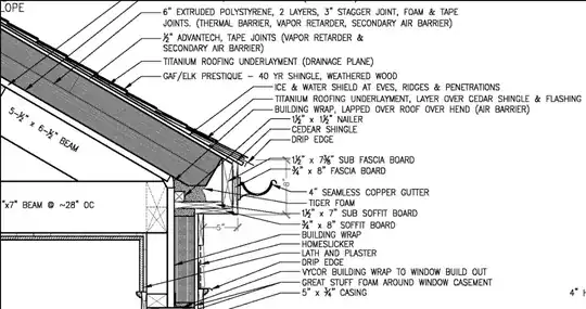

  • Fine. There should be a L shaped flashing from the lean-to wall to the first course of the shingle. If I see some picture, I will post it here. – r13 Mar 28 '21 at 23:15
  • See the bottom most picture just added. – r13 Mar 28 '21 at 23:20
